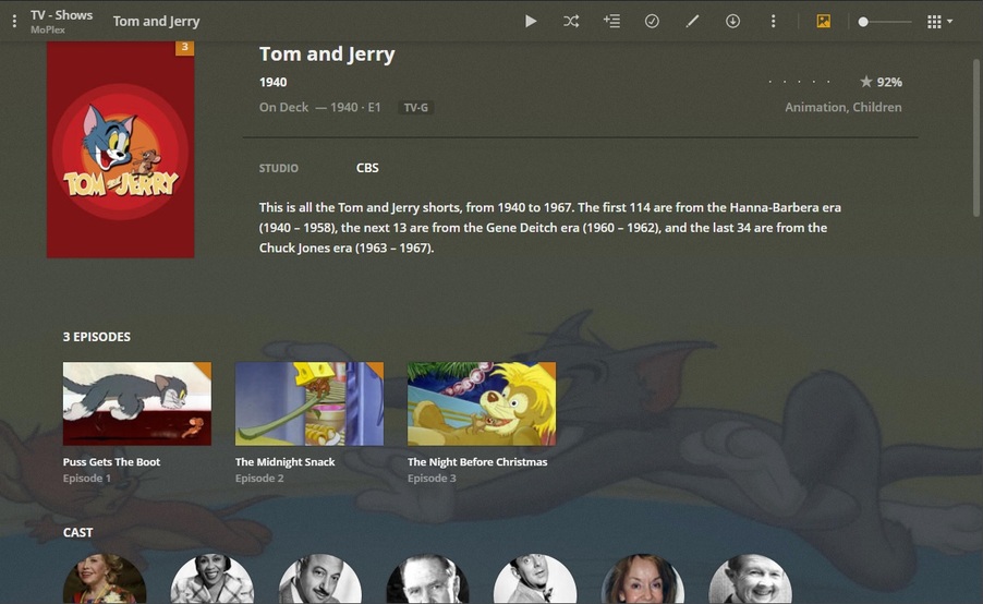

A TV Show Library Folder\
...Tom and Jerry\
......Season 1940\
...........Tom and Jerry - S1940E01.mp4
...........Tom and Jerry - S1940E02.mp4
...........Tom and Jerry - S1940E03.mp4
