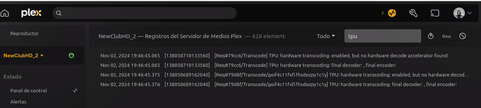

Nov 01, 2024 22:03:42.227 [131335131769656] DEBUG - [Req#1e3/Transcode] TPU: hardware transcoding: enabled, but no hardware decode accelerator found
Nov 01, 2024 22:03:42.227 [131335131769656] DEBUG - [Req#1e3/Transcode] [Universal] Using local file path instead of URL: /media/Seriály/The Witcher (2019)/Season 1/The Witcher - S01E01 - The End’s Beginning.mkv
Nov 01, 2024 22:03:42.227 [131335131769656] DEBUG - [Req#1e3/Transcode] TPU: hardware transcoding: final decoder: , final encoder:
Nov 01, 2024 22:03:42.227 [131335131769656] DEBUG - [Req#1e3/Transcode/JobRunner] Job running: FFMPEG_EXTERNAL_LIBS=‘/config/Library/Application\ Support/Plex\ Media\ Server/Codecs/db205f4-631e8759786d054613dad5b2-linux-x86_64/’ X_PLEX_TOKEN=xxxxxxxxxxxxxxxxxxxxxxxxxxxxxxxxxxxxxxxxxx

Nov 01, 2024 21:12:14.550 [140000733702968] DEBUG - [Req#aa/Transcode] Codecs: testing h264_vaapi (encoder)
Nov 01, 2024 21:12:14.550 [140000733702968] DEBUG - [Req#aa/Transcode] Codecs: hardware transcoding: testing API vaapi for device '/dev/dri/renderD128' (Arrow Lake-U [Intel Graphics])
Nov 01, 2024 21:12:14.550 [140000733702968] ERROR - [Req#aa/Transcode] [FFMPEG] - No VA display found for device /dev/dri/renderD128.
Nov 01, 2024 21:12:14.550 [140000733702968] DEBUG - [Req#aa/Transcode] Codecs: hardware transcoding: opening hw device failed - probably not supported by this system, error: Invalid argument
Nov 01, 2024 21:12:14.550 [140000733702968] DEBUG - [Req#aa/Transcode] Could not create hardware context for h264_vaapi
Nov 01, 2024 21:12:14.550 [140000733702968] DEBUG - [Req#aa/Transcode] Codecs: testing hevc (decoder) with hwdevice vaapi
Nov 01, 2024 21:12:14.550 [140000733702968] DEBUG - [Req#aa/Transcode] Could not create hardware context for hevc
Nov 01, 2024 21:12:14.550 [140000733702968] DEBUG - [Req#aa/Transcode] MDE: Selected protocol dash; container: mp4
Nov 01, 2024 21:12:14.550 [140000733702968] DEBUG - [Req#aa/Transcode] MDE: analyzing media item 1

Tone mapping and hardware accelerated video encoding not working on a ASUSTeK COMPUTER INC. NUC14RVK-B
Ubuntu: 24.04.1 LTS
Kernel: Linux 6.8.0-48-generic
CPU: Intel® Core™ 3 100U
GPU: Intel® Graphics (RPL-U)
PMS Version: 1.41.3.9148
Installation: amd64.deb package
If I disable only tone mapping it still doesn’t work

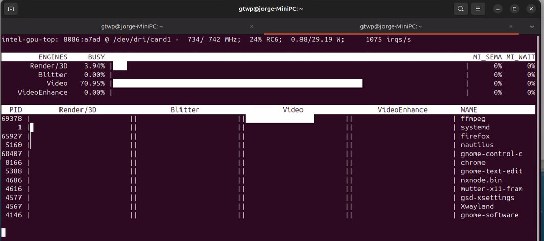

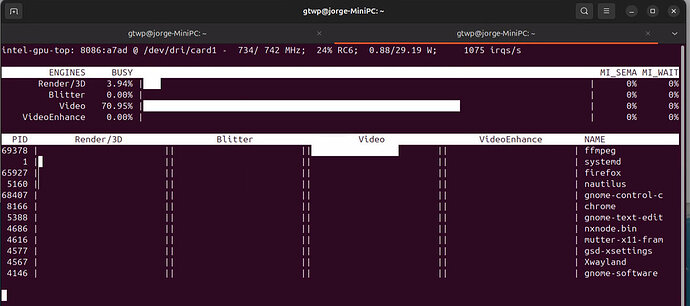

gtwp@jorge-MiniPC:~$ groups plex
plex : plex video render
gtwp@jorge-MiniPC:~$ lspci -k | grep -EA3 'VGA|3D|Display'
00:02.0 VGA compatible controller: Intel Corporation Raptor Lake-U [Intel Graphics] (rev 04)
	DeviceName: Onboard - Video
	Subsystem: ASUSTeK Computer Inc. Raptor Lake-U [Intel Graphics]
	Kernel driver in use: i915
works with ffmpeg
