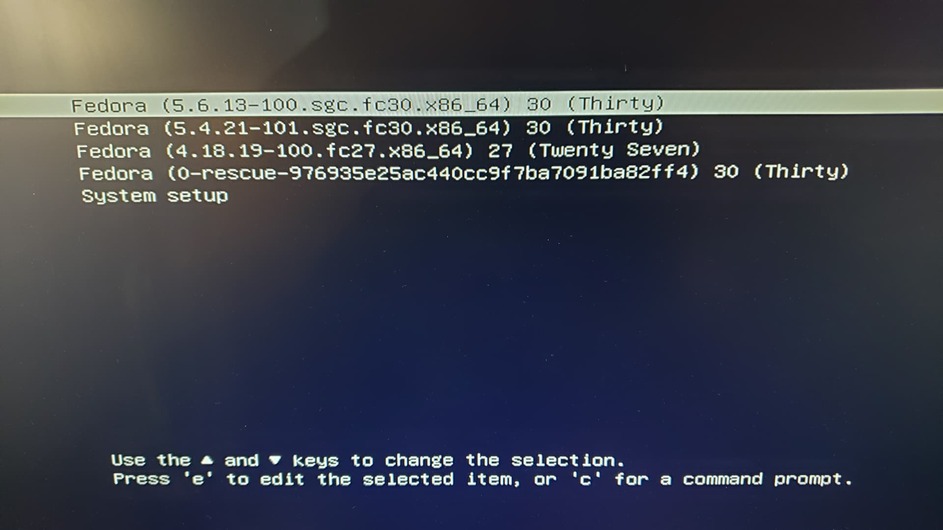

PLEX doesn't do HW Transcoding on Fedora 30 (ver 5.6) running on Intel i9-9900 (SGC SonicTransporter)
Server Version#: Version 1.24.2.4973
Player Version#: Version 1.33.0.2444-a220eae4
I’m having a problem with Plex Media Server running on my Small Green Computer (SGC) SonicTransporter i9-9900 3.3Ghz which is running a proprietary version of Fedora (5.6.13-100.sgc.fc30.x86_64) 30 (screenshot attached).
This is similar to the problem identified in this post:
[SOLVED] Plex doesnt do HW transcoding on Ubuntu 18.04 with i9-9900 (tone mapping related) - Plex Media Server / Desktops & Laptops - Plex Forum
No evidence of HW Transcoding and numerous buffering issues at the players.
Despite numerous help desk requests to SGC, they don’t seem to understand why Quick Sync isn’t working on their server. I suspect it a software issue with their OS.
Thoughts on where to start?
Thanks,
Herb…

All I can give you is a screenshot of the SonicOrbiter OS (SGC’s custom Fedora OS) which shows
the 3 apps that I have installed, amongst the Available Apps that SGC authorizes to work with their streaming appliance.
