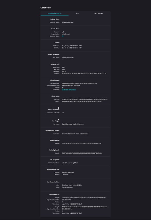

No setting on the config
# key_type = ecdsa
key_type = rsa
DID generate an RSA key, works with the working version. Breaks with the broken version.
The certificate details look the same as my custom certificate that I’m using.

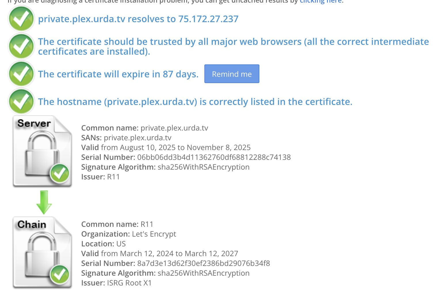

I have tried both full chain and cert plus chain. The cert is valid because the last production release of Plex served it correctly. I want to try the permission changes when I have free time this weekend, but the cert is valid.
In your previous post I do not see you adding the root certificate in the commands. Try adding it and try again.
Again, the full chain has been posted in this thread, and is served from the previous version of Plex correctly:

Aug 13, 2025 02:17:51.525 [138329095957136] DEBUG - [CERT] Loaded a user-provided certificate for /CN=plex.urda.tv.
Aug 13, 2025 02:17:51.525 [138329095957136] DEBUG - [CERT/OCSP] no URL available
Aug 13, 2025 02:17:51.525 [138329095957136] WARN - [CERT/OCSP] getCertInfo failed; skipping stapling
