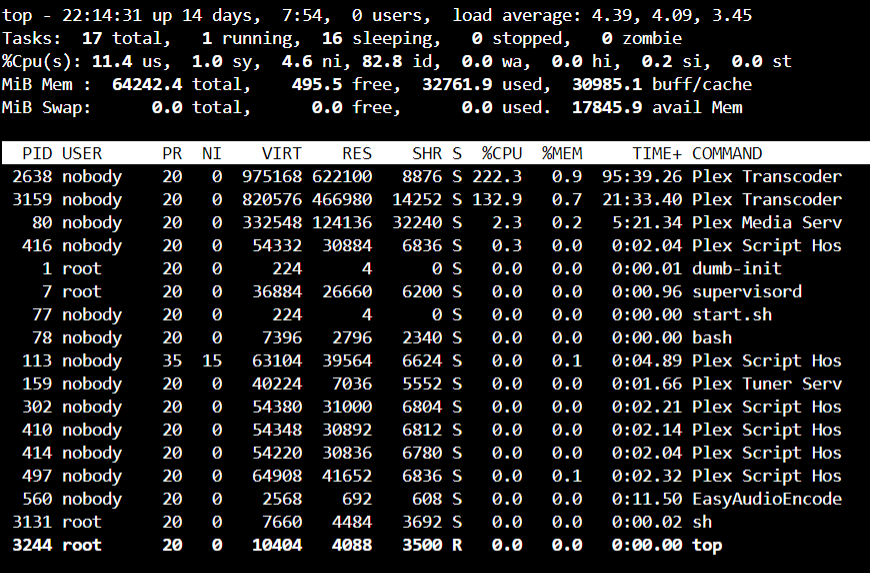

Would you please go into the container and see what PID 1 is?
I am looking for /bin/s6-svscan .

It tried to executed(I didn’t have plex stopped) trying to figure out how to force it to stop but does seem to got through the OS checks.
ChuckPa
December 14, 2022, 4:58am
21
My checks are for the main containers so yeah, at this point, it’ll NOT stop if Plex is running.
I thought you had plex stopped so we could develop this ?
Are there any control scripts at the top (root directory) ?
Is there anything in /etc to launch it ?
