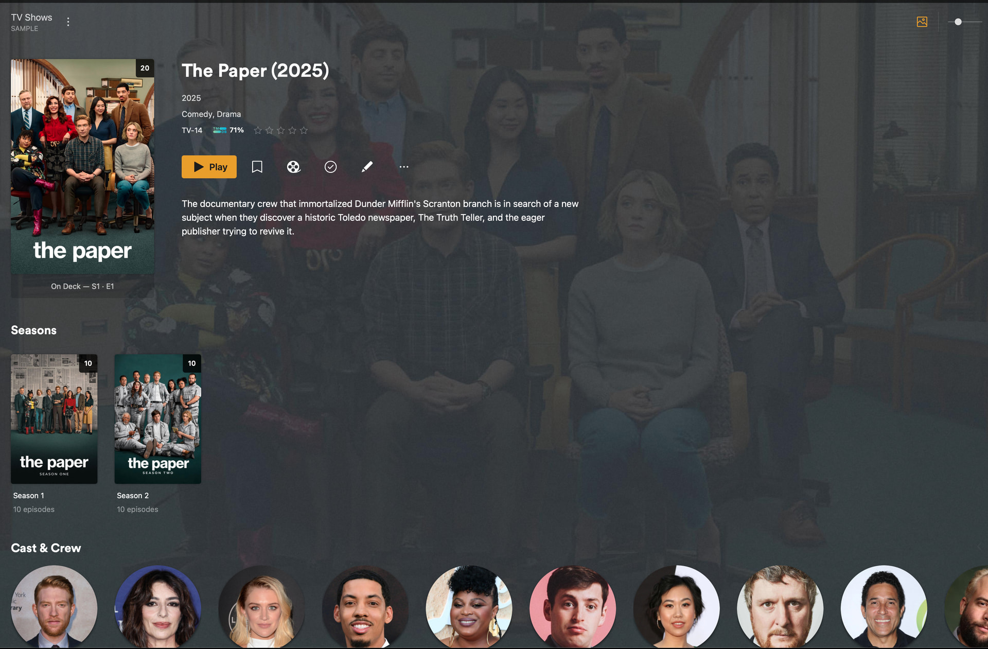

I’m having an issue with Plex where it treats each episode of a particular season of a show as the entire season. For example:
  • Watching one episode of that season makes Plex think I’ve watched every episode of that whole season.
  • Watching 10 minutes of an episode from that season makes Plex show that every episode from that season has had the first 10 minutes watched.
  • Manually marking an episode as Watched marks every episode from that season as watched (and vice/versa with marking as Unwatched).
  • It only affects the second season of a show; it does not affect season 1 of that show, nor has this problem shown up in any other show in my library.
  • Other things of note: Plex initially wouldn’t scan the second season into the library after several attempts (despite the naming convention of the files being correct). I eventually removed it from the library and added it back (read: moved the files to a new location, then ‘deleted’ the show, then moved the files back and rescanned) to get it to show up. Once that finally got the first season and new second season to show up, I discovered the above issue.
I can’t tell if it’s specifically a PMS 1.43.4 issue, but it’s never happened to me before, in several years of using PMS.

The show is called The Paper. Here’s a snippet of the naming structure, which is what I’ve been using for at least a decade:
NAS Volume/
├─ Video/
│  ├─ movies/
│  ├─ tv/
│  │  ├─ The Paper/
│  │  │  ├─ Season 01/
│  │  │  │  ├─ The.Paper.2025.S01E01.Pilot.mkv
│  │  │  │  ├─ The.Paper.2025.S01E02.The.Five.Ws.mkv
│  │  │  ├─ Season 02/
│  │  │  │  ├─ The.Paper.2025.S02E01.The.Best.of.Us.mkv
│  │  │  │  ├─ The.Paper.2025.S02E02.Weekend.Ned.mkv
Notes:
  • The TV library in Plex is pointed to the tv directory on my NAS.
  • There are actually 10 episodes per season of the show in question, but I limited it to give an example.
  • I’ve truncated the filenames to remove resolution/audio/source info.

Thanks for that example @ChuckPa! Thankfully, Plex does officially support periods in the naming conventions:
It does not matter if you use dashes, dots, or just spaces.
Since all my episodes are like that and it would take quite a while to change everything in my library, this is good news for me. In other good news, I did some digging and found that my local .nfo files (despite not using the NFO scraper, which is another issue) had missing information in them which was causing the issue! None of my episodes of The Paper season 2 had their uniqueid XML tag set to any episode number at all, so it seems that Plex considered every episode to be equivalent to the season. Very odd, and something I never had an issue with before, but updating my .nfo files, removing the show, and re-adding it fixed the problem.
