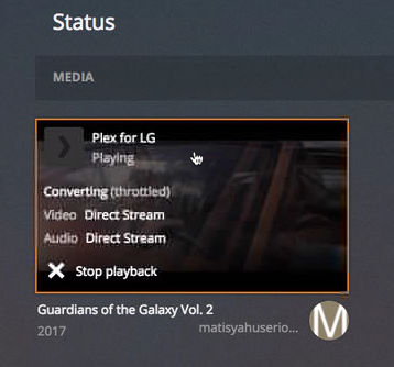

If you want to know it it truly is a transkoding issue, you could login to your server using WebApp, while the TV uses the PlaxApp to stream media. Using the WebApp at Status->Current Playback (See Screenshot), when hovering th cursor above the relevant playback, you can see if transkoding happens and how.

here’s the same file, same tv, same server, but using the LG PLEX app:

Well although your TV when using the LG Plex App (2, Screenshot) also uses Direct Stream, therefore no actual Transkoding should be in effect, your Conversion is throttled.
I’m not realy sure if this refers to either your Server bottlenecking the transkoding (e.g. CPU) or if this refers to a limitation in bandwidth. If the later one applies, it obviously shoouldn’t be due to your network, since it works in the DLNA onfiguration. Please check, if when you use the LG Plex App, your client is recogniced as in the same network as the server and therefore is treaded as a local device. If not, it might be possible, the server applies a upstream bandwidht limitation and therefore has to transkode the video to a lowe bitstream, so it fits your limitation.
