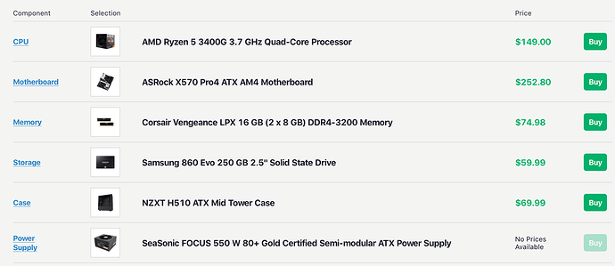

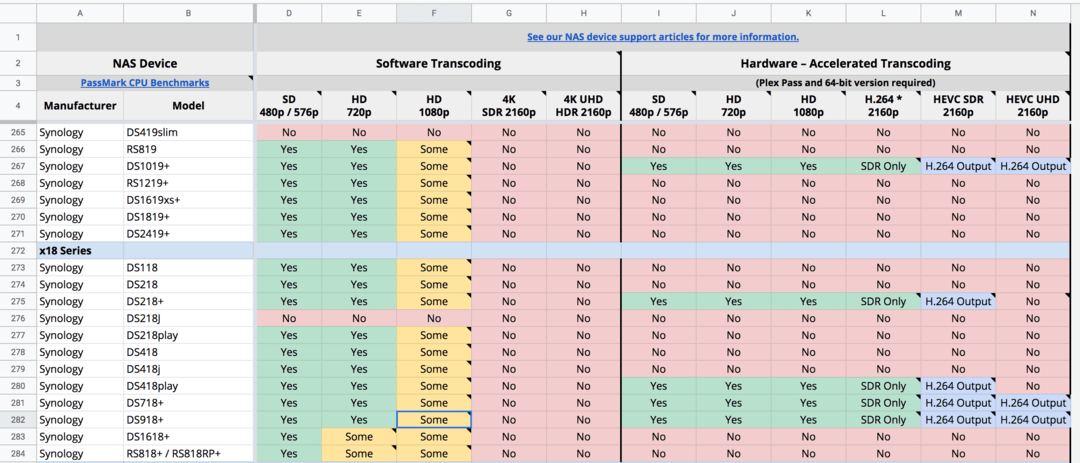

Hello everyone, being a rookie i read through all the comments and had a question about a build i am thinking for my plex server and the media is on a NAS and dont want any kind of compromise on streaming files 720p upto 2160p. Also have the capability of transferring files from SFTP server to my NAS with no lags and with the best speeds even while streaming.
I see tha ryzen 5 3400g doesnt support 4k or hardware transcoding as it doesnt meet the benchmark is there a way to add a video card to meet all the requirements and make it full. And all hardware transcoding features are met according to the sheet. Posting the build screenshot and NAS screenshot

There is no support for hardware transcoding with any AMD CPUs or Graphics Cards at this time.
Adding support for it is on Engineering’s wish-list of things to do. When that might be is unknown.
Currently, Intel QSV (the CPUs ASIC) and Nvidia GPUs are supported.
Does this answer your question? ( I maintain the NAS Compatibility Guide)
hello there, so u have seen my list out there, so adding a Nvidia GPU will help with the amd ryzen 5 3400g for 4k content? I am just building the first one so trying to understand whats best. Or no matter what i do, does my NAS support the same related to 4k??

I do not know if it is possible to use an Nvidia card in a Synology NAS.
I have not been asked to add Nvidia support to Synology NAS systems.
no i meant nvidia card my desktop setup. I dont think i am making any changes to NAS. All i was looking at was the desktop build if it can do hardware transcoding if selected for 4k and 2160p files.
I think you have different questions?
- What hardware transcoding can the Ryzen CPU support?
- What hardware transcoding does a Synology NAS support? (You added a screenshot)
First:
- There is no hardware transcoding support for AMD CPU or AMD GPU cards at this time.
- Intel QSV (Quick Sync Video) and Nvidia cards only.
Second:
- The Synology NAS model support is based on: Intel CPU without external GPU.
- We are considering adding more information to the NAS Compatibility Guide.
While not clear what you’re asking:
If you add an Nvidia GPU card to your Ryzen system, with the Nvidia drivers, Plex will see the Nvidia and use it.
