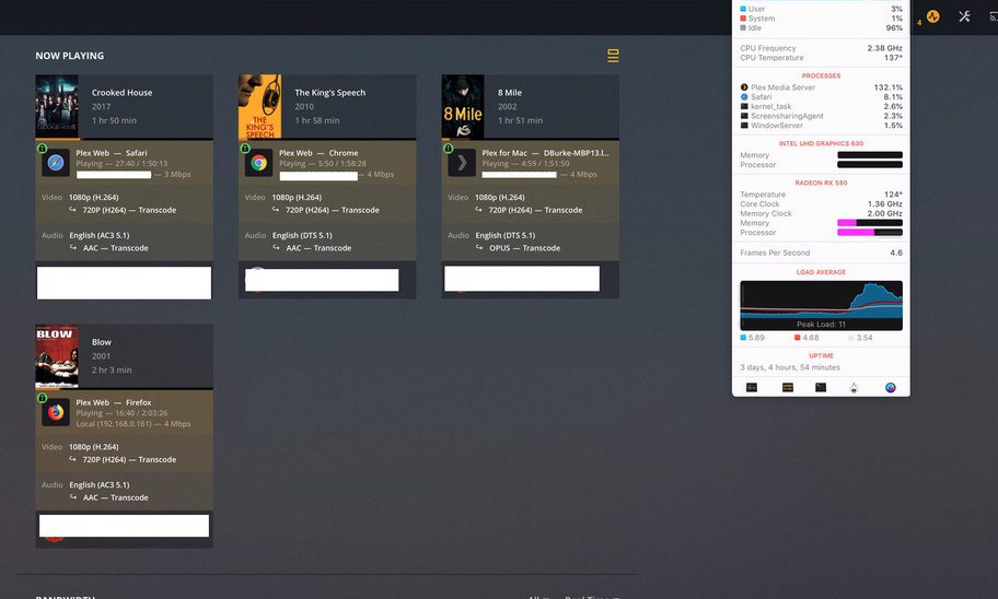

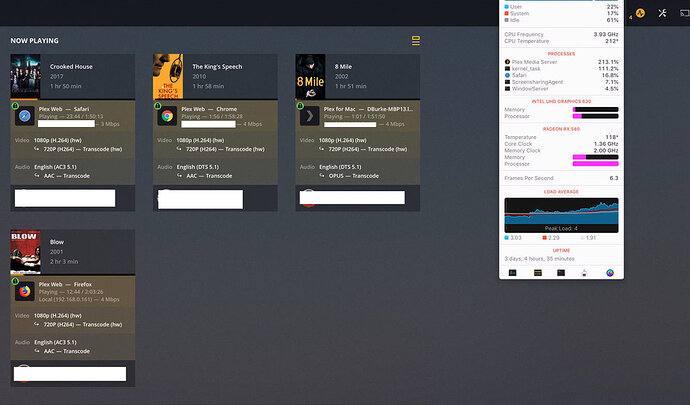

I wanted to reply back to this in case it helped someone. I did some testing using an AMD RX580 for transcoding (Mac). It’s far from very scientific but it’s consistent with other findings.
So I tested 4 transcode streams using the dedicated AMD GPU for transcoding vs regular software transcoding.
The files were 1080p and had bitrates that fell between 8-9Mbps and I transcoded them to 720/4Mb
Using the dedicated AMD for transcoding the 4 streams had the GPU pinned at 100% and (CPU use was pretty insignificant and fluctuated around 10-20%). This is pretty consistent with @slothtechtv findings he posted on reddit:
What’s interesting is with hardware transcoding turned off, you can see the AMD GPU was still being utilized quite a bit albeit not as intensely it would ounce between 30-50% and the CPU use was roughly the same:
