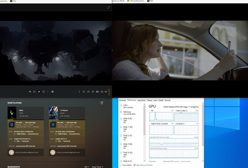

Maybe you can make some compromise with windows, I am using windows 10 and 2400g. It can use hw transcoding and its able to make 2 simultaneous transcodes of 4k to 1080p or something else. Problem is that is limit on 2400g, while doing that only direct streams are working and no HDR tone mapping, that is going directly to CPU in which case is unable to do anything else. I have ordered now 3600xt for server but having second thought now on 4650g. My doubt was if its same transcoder as in 2400g it want do much better…
If you try windows 10 with that configuration please post results, I would really like to know if I made mistake. Just put realistic one, not that bs of millions of transcodes. I have tried intel and it works much worse, it was older core i5 6400 but still…
P.S. Another observation, hw transcoding works only when I am connected to remote machine via RDP, otherwise CPU only. Trying to find reason.
Reason found. When you enable and use RDP windows create RDP GPU driver and its unable to use it for GPU transcoding so Plex want use it. Can somebody tell me if there is a way to manually switch GPU for transcoding in plex? I override it with removing RDP and now using TW for connections. So far so good.
P.S. So it works with 2 streams 4k HDR to something else without HDR tone mapping enabled - CPU is 35-40%
