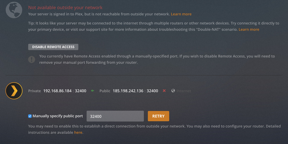

So, after a long drawn out process, I have an ipv4 static IP address from my ISP provider. Canyousee me see’s it, Plex picks it up.
However, I still can’t see the port on https://canyouseeme.org/
Current configuration is a TP Link Modem with 32400 open both in and out and directed to my LAN connected Google WiFi.
Google WiFi set up to forward int/ext port 32400 > NAS IP.

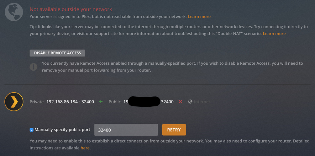

This is what I get on Plex Remote Access settings:
I feel like I’m 90% of the way there, can anyone help with the final few steps?
Is the ‘public’ address shown on there starting with 192.168.x.x ?
no, it’s 193.114.x.x
OK, this appears to be a publicly routable address range.

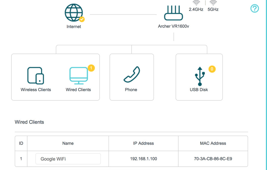

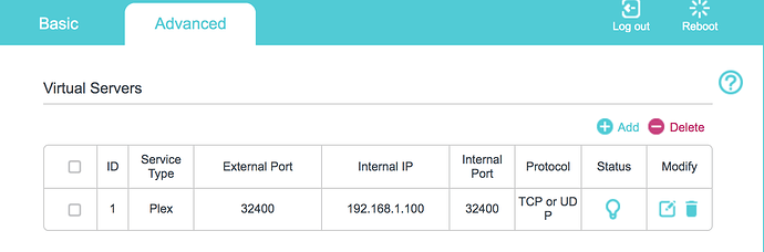

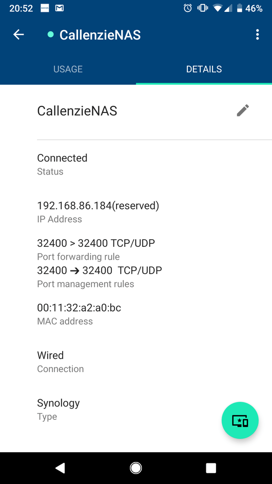

Can you make screenshots of the relevant configuration menu pages?
TPL
GWF
So the first 2 screenshots are from the TPL device?
And the 3rd is from Google Wifi or from your NAS?
btw, you only need to forward TCP, not UDP.
Exactly, 1&2 are the TPL “modem”. The final one is the Google Wifi device. I’ve set up the port forwarding to the NAS IP on Google WiFi.
I’ll change to TCP :slight_smile:
Hey @OttoKerner, is there anything you can think of to troubleshoot?
Why does it have separate lines for ‘Port forwarding rule’ and ‘Prot management rules’?
I get what port forwarding is, but what is the other one?
I’m not actually sure, but if I add port forwarding it automatically adds the port management :man_shrugging:t3:
When I go to settings on the GWIFI for the NAS connection I can set up ipv4 port forwarding or ipv6 port opening. But, I’m pretty sure I switched off ipv6 in the NAS for something else.
