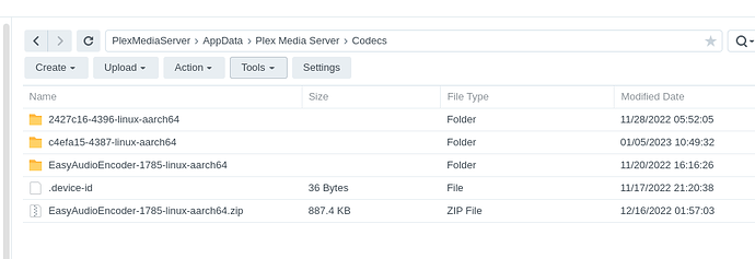

Please open FileStation
Navigate to: Plex / Library / Application Support / Plex Media Server / Codecs
You will see multiple files and folders.
  1. Stop PMS
  2. Please delete all files and folders EXCEPT .device-id (the license file)
  3. Start PMS
  4. Retest
Example: (my DSM 7 PMS)
