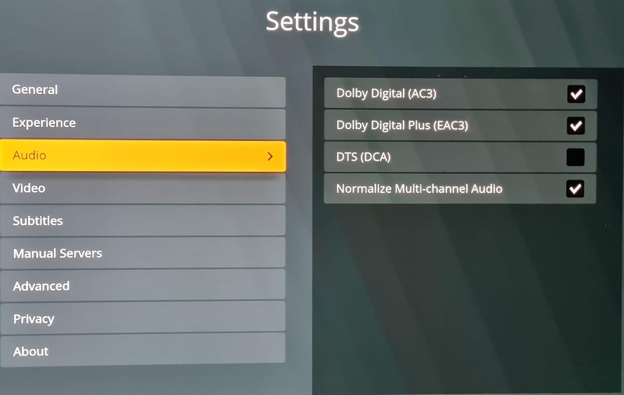

I hate to mention this but Emby did a easy fix with this as in the options there are check boxes for DTS and DTS-HD decoding, if unchecked it will transcode. Lifetime Pass member here also…
We used to have an option like that ages ago but it was removed for some reason. I guess they wanted it to me more automatic, which makes sense, but it’s obviously not working so my hope is that they either fix it or add that option again.

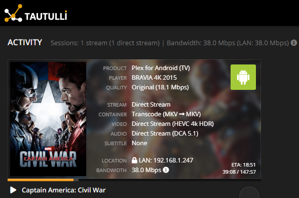

FreeNAS-11.3-U4.1 with PLEX Version 1.20.1.3252 wired connected to Sony Android TV (BRAVIA 4K 2015) with PLEX ver: 8.5.1.19778 (2c9485c3)

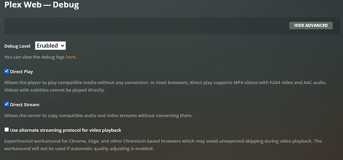

Setup on PLEX (FreeNAS): Direct Play is ON & Direct Stream is ON. (screenshot is attached)
Do PLEX have a workaround for this, or will PLEX release a fix for this?
2020-08-29 17_02_49-Tautulli - Home _ NAS-PLEX Plex Media Server.log (1.1 MB)
