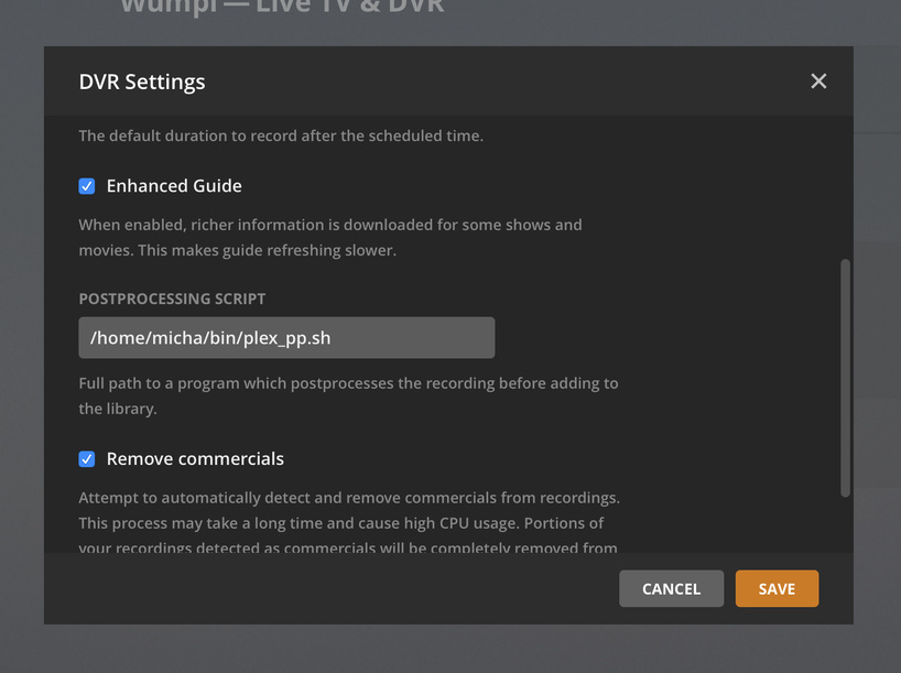

I created a simple post_processing script that just logs $1 (the 1st argument to the script call) to a local file.
I want this to be executed whenever a DVR recording finishes to ultimately convert the recording and notify me that a new recording is available.
I configured it in the server UI
However, I do not see it getting executed (because the log file doesn’t get updated) and also I don’t see any indication in any log file (which should I be looking for in anyways?) that the post processing step actually executed…
Any ideas?

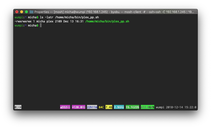

Unlikely since the script is 777 and gid plex… I can run it as plex user or user with plex gid no problem from the command line. In the case it isn’t accessible I’d expect an error message somewhere in the (debug) logs…
