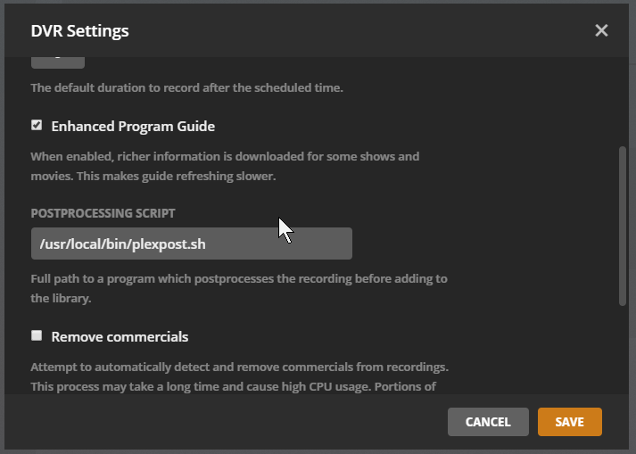

Screenshot of your DVR settings showing the Post Processing script configured
Okay, here it is.

Does the Plex Media Server logs show it executing the script? Or an error that the script could not be executed?
Well, I only looked at one log and didn’t find it.
/var/lib/plexmediaserver/Library/Application Support/Plex Media Server/Logs/Plex Media Server.log
(I don’t see one separate for DVR)
-Frank
All the DVR entries are included in the Plex Media Server logs. When a recording ends there should be an entry about Post Processing. Should look something like this:
Jan 12, 2018 07:30:01.088 [14000] DEBUG - Job running: E:\Dropbox\mcebuddy_script\MCEBuddyScriptv2.bat “G:\TV_DVR.grab\90f6c494dcf461528bfd3b20d18b772b661127d3\The Big Bang Theory (2007) - S10E01 - The Conjugal Conjecture.ts”
It appears all that I had to to was to hit save on the DVR configuration. Looks find now.
