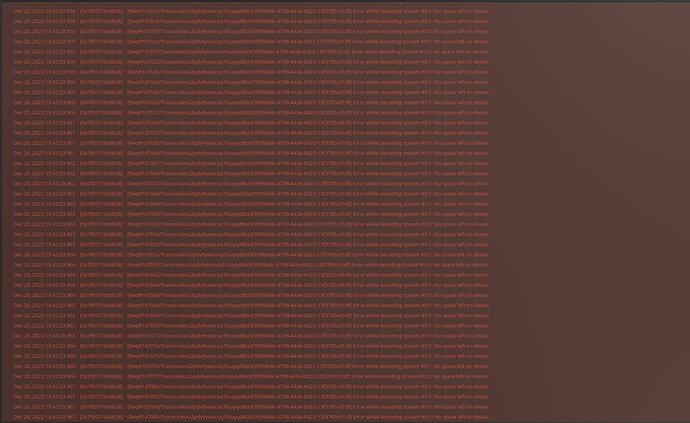

Would you like me to test 1.30.1 as well. Upon installing 1.30 I got the following error spammed in the log
Dec 19, 2022 23:05:08.768 [0x7fb577373b38] ERROR - [Req#8e62f/Transcode/32qdw1d05n7rzbxhykdnjr20/0ccf8c19-aa55-4587-a5f9-47a8d2b4a507] Error while decoding stream #0:1: No space left on device
I am using /dev/shm for my transcode directory and the system has 256 GB of RAM and is no where near capcity.

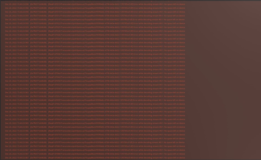

Screenshots are inadmissible in court :rofl:
That’s the error I recreated.
