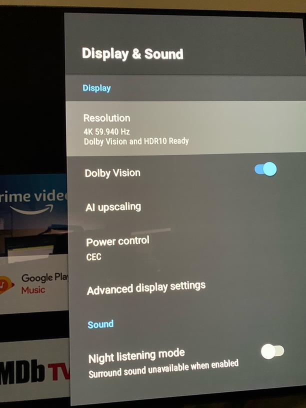

  1. Shield main video output (Pic 1) first. Set this to match the best/desired resolution of the projector.
    – The Shield will test the resolution before allowing you to keep it.
    – When you go to the “Resolution” and click it, you will be given a list of choices.
    – If the projector is 4K capable, it is extremely important to have 4K-rated cabling.
    – If it’s Dolby capable - select that too (if you want to play Dolby Vision content)

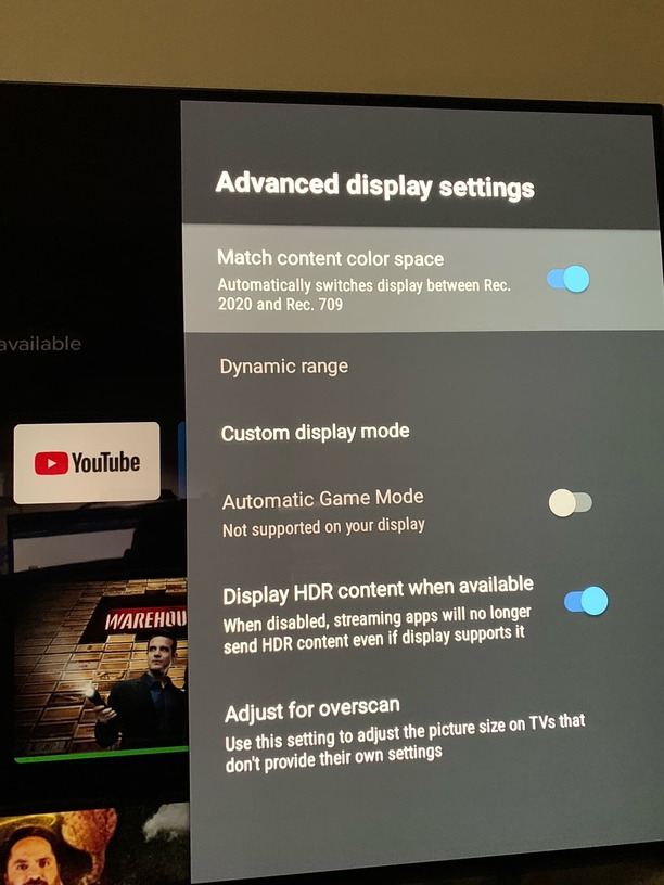

  2. Advanced display settings allows you to do exactly as the wording states. I recommend setting these as I have them
    – Match content color space IF the Projector is HDR capable
    – Display HDR content – (if appropriate)

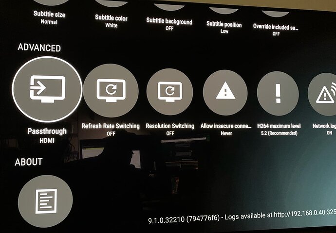

  3. Lastly, set the Plex app as I show here. (which I believe you’ve already done)
