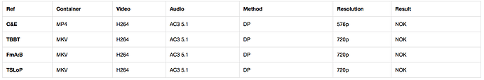

To see if the new beta version fixes the playback issue that was previously seen, I tried a few media items that were not working well before.
Unfortunately I must report that with Passthrough on Disabled (the default and wanted setting) playback is still not as expected. Anything with AC3 audio is being Direct Played and not working well. What I find odd myself is that the audio seems quite fine, it is the video that is not showing while one hears the audio play. Note that this is not a new development on the more recent code, but was the same with my previous tests as well.

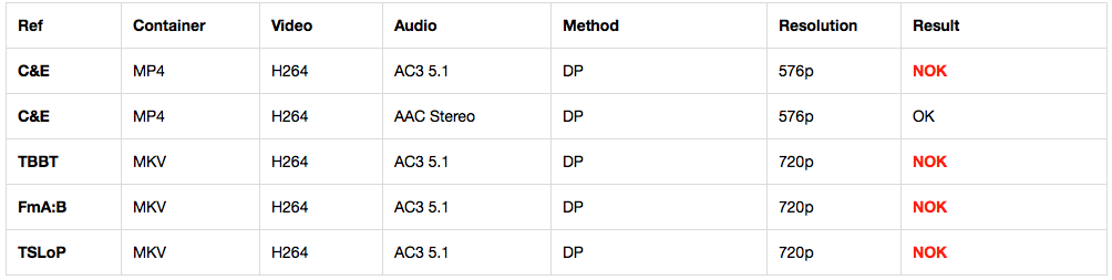

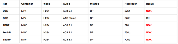

I reran the tests with both servers running 1.3.0.3059. The setting at Advanced > Passthrough was again put “Disabled” like we would ideally want it to be.
Unfortunately playback of media using AC3 audio is still being Direct Played and not playing correctly. Switching “Passthrough” to Auto forces transcoding of the audio to AAC to take place which again makes the media play well.
