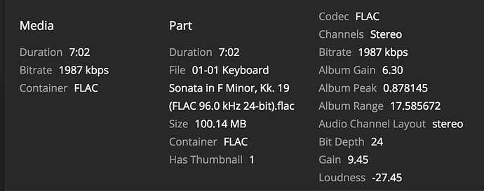

Basically anything I download from ProStudioMasters at 96k or higher errors out and ends up either sending a transcoding error to the screen or after 15 or so seconds gets transcoded to MP3. It makes those tracks unplayable in Plex through Nvidia Shield.
Attached is the XML file for one of the tracks with this issue.109138.txt (1.9 KB)

I am able to reproduce the error. As I expected. Direct play is tried by failing. Fallback to server transcode. I will send the file to engineering.
And BTW, the same files play direct through the ROKU using Plex.
Thanks. I was able to find the issue files by uglymagoo. The team has looked at the issue. There appears to be a problem with the audio player in Android handling that format. The audio player is fairly basic and my guess is failing on the 24-bit encoding.
FYI - A CD is only encoded in 16-bit, so you don’t get any better quality using 24-bit, unless your source is an audio master. I would suggest just stick to 16-bit.
We are looking to update the audio player in the future but I do not have any info on when that might happen.

I don’t think it is specifically 24bit. Many of my 24bit files play without issue. The downloads from ProStudioMasters that are high res like the files I provided are the only ones that will not play on Shield TV. A HUGH issue for anyone that listens to high res content. Sometimes it will transcode (and sometimes it just fails), but when it does work it transcodes to MP3 after many seconds of silence (for each track) which sort of defeats the purpose of high res music files. Even in Android fails on a particular file I would think PLEX should be able to fall back to something more reasonable than MP3.
