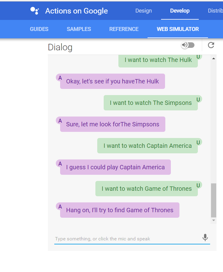

Well, let’s just say I’ve got the interfacing betwen Phlex and API.AI worked out.
Now it’s just a matter of going nuts with the possibilities. This is gonna be fun.
