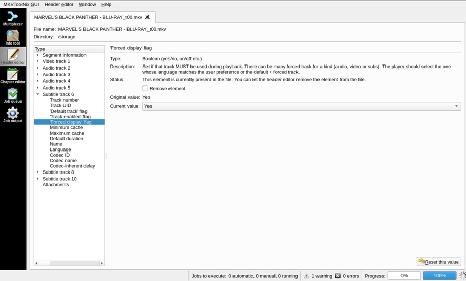

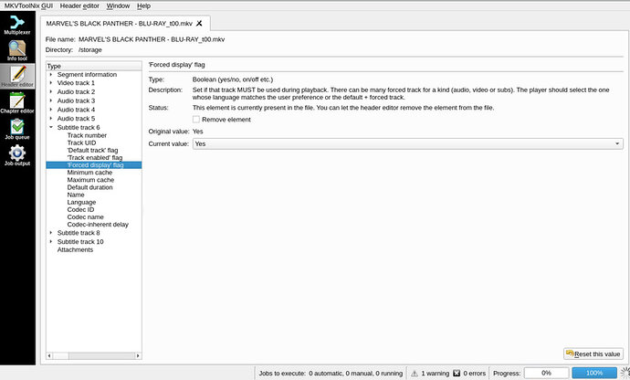

I never got Forced English Subtitles working right outside of burning them in with HandBreak. So I’m trying to flag it using MKVToolNix but that doesn’t seem to be working right. I think I identify the Forced English Subtitle fine, but when I go to play it it’s playing the normal English Subtitle, even though it’s marked as Forced on the selection as you see below. Can anyone that has it working right walk me through the right steps? Would def appreciate it!

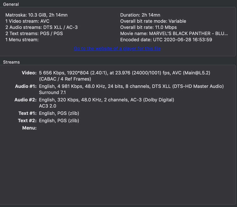

Yup, looks like it’s the same file. Here’s the output in Mediainfo. Am I missing something somewhere that the Force English isn’t being flagged or something? That leads me to believe it’s the same file it’s mixing together or something.
My Blu-ray rip of Black Panther has no forced subtitle track.
Use the Text formatted output in Media Info. Look at the Count of Elements for each subtitle track. Make sure they’re not the same track. FYI, for some reason, the “Count of Elements” is twice the number of subtitle lines.
You can also use Subtitle Edit to examine the subtitle tracks. You don’t have to run OCR on the entire track. Just open the movie in the application. You can see timings, number of lines, etc.

Shouldn’t that be it since Forced showed as Yes? I think that’s what’s confusing me. I wonder why on yours it doesn’t.

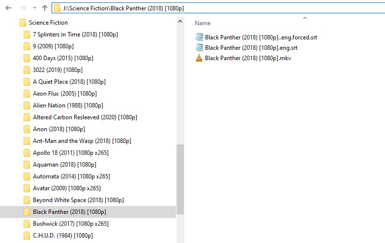

But chances are those are the ones you didn’t get off the BluRay - and since they’re text based - will Direct Play on everything but your wristwatch -and maybe that too.
Plex may never actually pick those forced subs automatically - it depends where they are - embedded/external - and what order they’re in. If embedded - forced better be first. Not sure what happens for externals, but at least if they’re marked/named properly - you can pick the right ones.

ALL those tracks marked Forced in MakeMKV?
ARE EMPTY!
If there are any forced tracks they’ll be a separate track (that will also have an empty forced slot) and they’ll be the ones with the fewest elements.

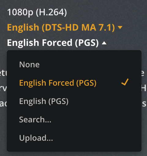

Plex picks the forced subtitle track for me, even when it is not the first track.
Ran a quick test. Added Avatar Blu-ray rip to a test movie library. Forced subtitle track is the second track and it is auto-picked in Plex for Windows & Plex Web. I added only the MKV file to the library. No external subtitles.
