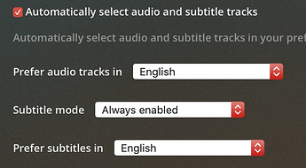

Plex seems to prefer to use a Forced sub even though I have a non-forced sub and settings set appropriately.
Plex will ALWAYS use a forced sub first. <— in the default language.
The ‘forced sub’ settings you enabled is for ‘Searches’ only I would imagine. Sub look-ups at opensubtitles for Plex Pass members. That won’t change the power of an existing Forced Subtitle. It rules the day.
So there is absolutely no way for it to prefer a non-forced sub that’s available?
Other than ‘de-flagging’ or removing those forced subs - no.
Plex gives top priority to forced subs, 'cause in their normal use they MUST be played above ALL others.
You could flag those forced subs with another language. That’ll stop 'em dead.
:wink:

If you set it to ‘always enabled’, then it should use ‘full’/‘non-forced’ subs.
This sounds like a bug.
I don’t think it is a good idea to modify your files to work around a bug in Plex.
Is your server signed into your plex account? If it is not, the settings in your account don’t apply. You then want to go to Settings - Server - Languages instead.

You want ‘Shown with foreign audio’ then. This will activate ‘forced’ subs if present.
Otto - it’s working exactly as expected with ‘Always On’ selected.
Shown with Foreign Audio means I’ll get no subs at all unless they’re forced or I’m watching a Chinese Language film e.g.
I want the subs on always, but if there’s a forced track I want that one in priority - in case I’m lazy and don’t switch tracks for the full.
That doesn’t make sense to me. If I say ‘always use subtitles’ then I’m implying that I need them in every part of the movie, due to bad hearing. So I always want the ‘full’ subs.
