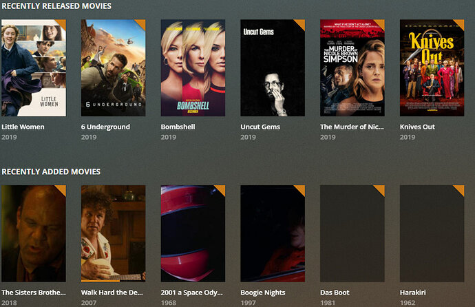

I updated FreeNAS from 11.2 train to 11.3 as well as iocage from 11.2 to 11.3.
I was able to manually update PMS fine in FreeNAS 11.2 using WinSCP but its directory changed in 11.3.
Fine, no biggy I find its location and was unable to update manually the same way. However, after the iocage update I would bet that I tried 31 times to no avail. Well, for one reason or antoher the 32nd time worked but now not only have I lost web GUI access to all of my server settings PMS also no longer retrieves any metadata either. Movies on the server from a certain date back are OK but movies added since have no metadata other than file name.
I was worried about those accessing it remotely but it appears to work fine.
Any help on how to correct this?

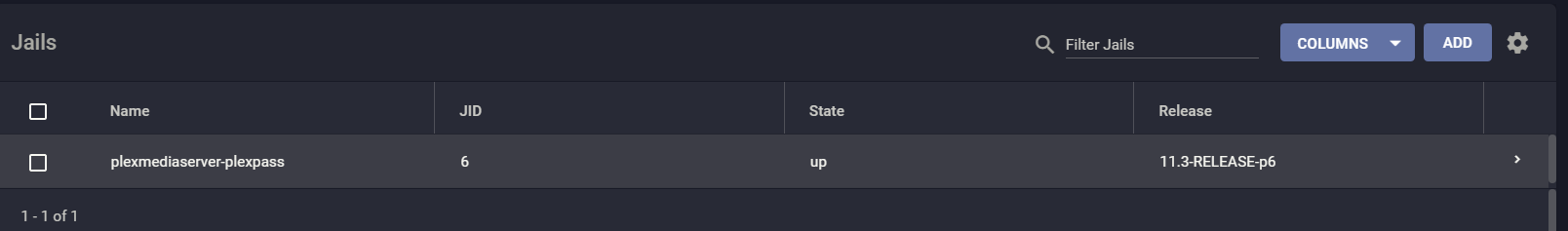

Here is a screenshot of shell:
hum this jail was created from the pluign so its pointing to other repos!

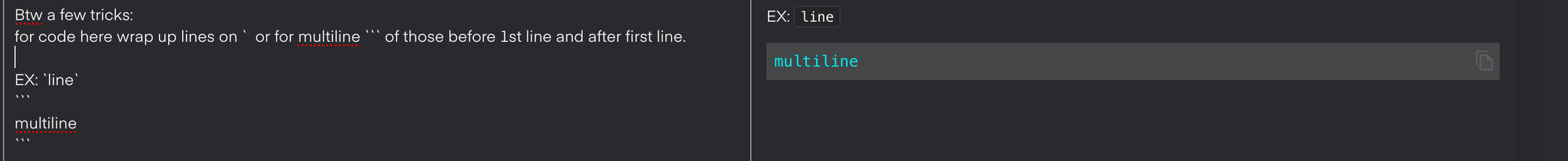

Btw a few tricks:
for code here wrap up lines on ` or for multiline ``` of those before 1st line and after first line.
EX: line
multiline

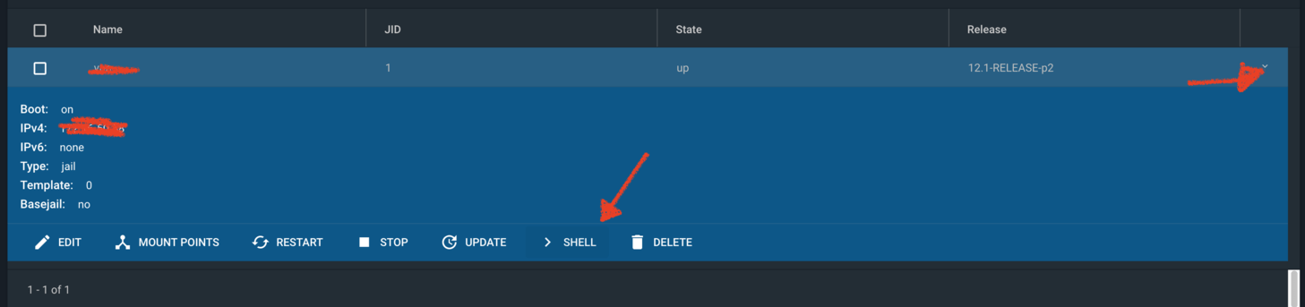

To enter a jail shell with iocage you can just use the ui option (in the jail) or from the host shell run:
iocage console JAIL_NAME
