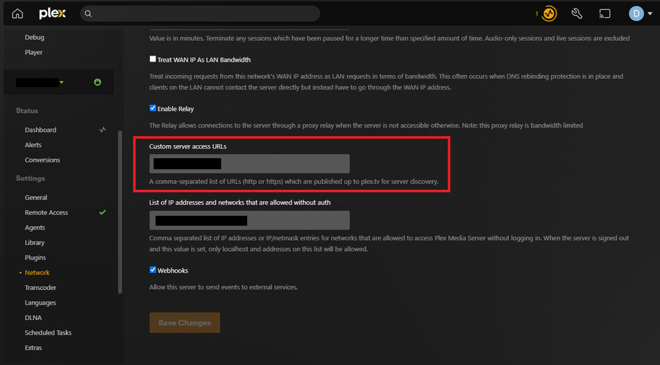

Since you used the word “Custom server access URLs”, I assume you filled in this?:
I think that, once you fill this in, your server tells Plex (the company) the IP address(s) that the server has, as well as everything in this box. Then when a client starts up it is given that list of IPs and it tries them one by one until it connects to the server. If this fails, the client then attempts the WAN address of the server and connects that way.
This means that if you want clients to connect via it’s VM internal LAN IP, then you need to make sure your routers are designed to route traffic in this LAN to the router that handles the LAN. Most likely, you need to set a route to this LAN in your own router - to forward all LAN traffic to the IP of the computer that runs the VM itself, as it is running a virtual router to handle this LAN network.
You can use the information in this post to see exactly what connection information is being published by your server:
As to how that information is determined, it depends. My experience is that it populates the list from:
  • Any interfaces on the local server which have a default gateway defined (or the specific interface specified in the server’s network settings).
  • Any custom server access URLs configured on the server.
  • (If remote access is enabled) The server’s detected public IP addresses. “Detection” here means what it determines to be its external IP addresses.
For each, the port used for the connection can be configured, except for the local interfaces; those will all use 32400.
I’d check what is being published and see if that matches your expectations.

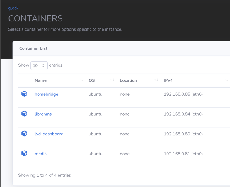

LXC (all the features of a VM without all the waste) and then serveral ESXi VMs for testing all the supported platforms.
I ran several Plex servers in LXC with ease prior to getting my NUC8’s to use instead.
