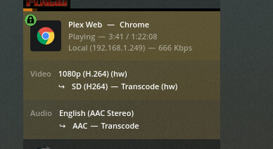

Confirming that it works for me, using a mere Athlon 200GE.
Screen Shot 2021-02-12 at 14.29.21
