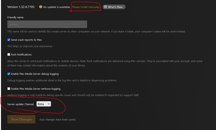

I guess I don’t understand how this is supposed to work. I can select the Beta update channel under the General settings page (as shown) and it provides a link to a manual download, but I don’t understand how to apply this in a Docker environment? Ideally there should be a “beta” tag made available on Docker hub.
@akmoney you do not need to use the beta update channel. Switch to the official PMS Docker image, use the plexpass tag, and let it autoupdate on the first run.
Updates within the Docker container will not work as changes are removed anyway on the next run. That’s why there’s a script inside the Docker image that grabs a new copy on every launch.
