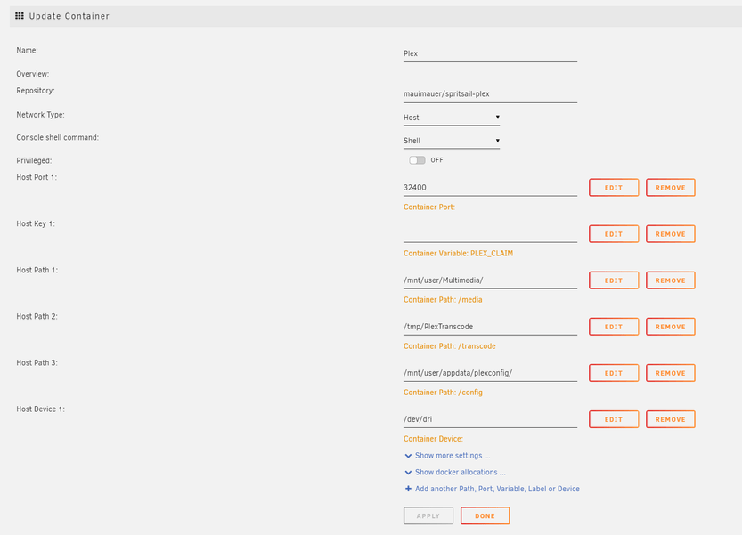

also using unraid here and having some trouble, could you show me how you filled out your docker template please? thank you!
Here below my template xml:

thank you! i will compare and see if I missed anything!
I am trying to use an r9 290x for HW transcoding, would that be any different setup than an APU?
This is my current setup for the docker container.
I also followed this tutorial to enable the AMD driver, just replace “i915” with amdgpu
