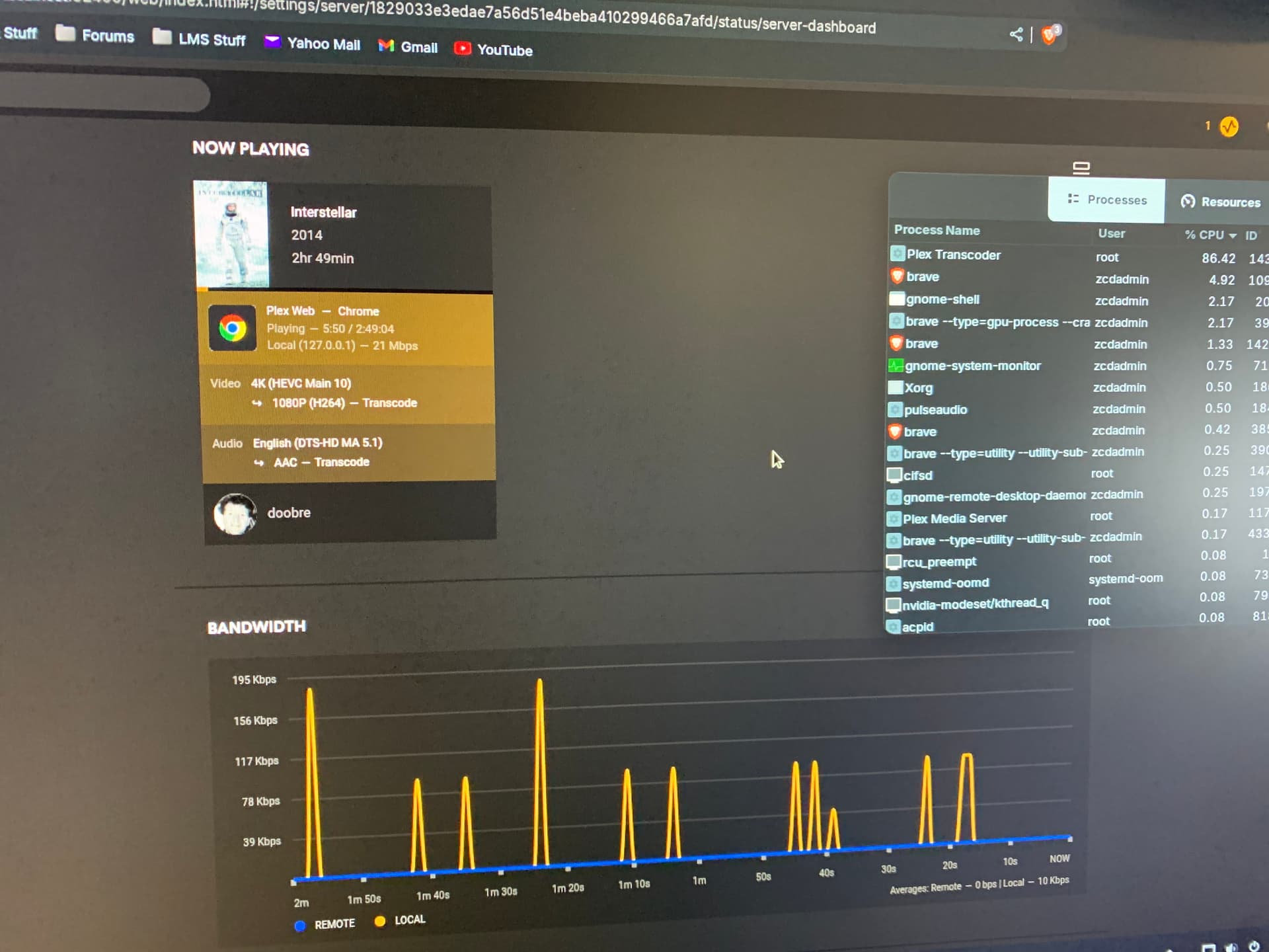

I am facing what I am calling a buffering problem when playing h265 files on the linux pc, but the same file on the win10 Plex version is fine. The local playback on Zorin is stopping every 10-12 seconds, the buffering circle appears, then plays for another few seconds, over and over. System resources show the CPU is running constantly at 80% on Zorin, 25% for the win10 while local playing AND remotely.
The hardware is obviously the same, the latest nvidia drivers are apparently installed and the 265 transcoding options are active on both systems. GFX card is GTX1050Ti.
This is a make or break issue for me. Where to start looking?
help please. Cheers CD

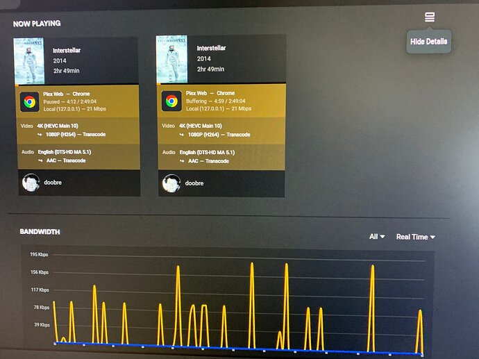

Hi there, thanks very much for your reply, hope the below is all you require.
I noticed that the Zorin plex started to playback in original resolution but after a few seconds changed to transcoding, but was showing it’s playback as “Convert to 20160p 4K (Maximum) 37.7 Mbps”, even though that is the same as the original file. Whereas the windows plex was playing original for local+webtv.app+iphone on 4G @720p, with relatively low CPU %.
There are two log files. I found that on he first try there were two transcode tasks running at the same time. These were using a combined CPU of approx 80%.
If I disable transcoding on the Zorin plex, I will immediately get the warning message “Not enough CPU for this conversion”.

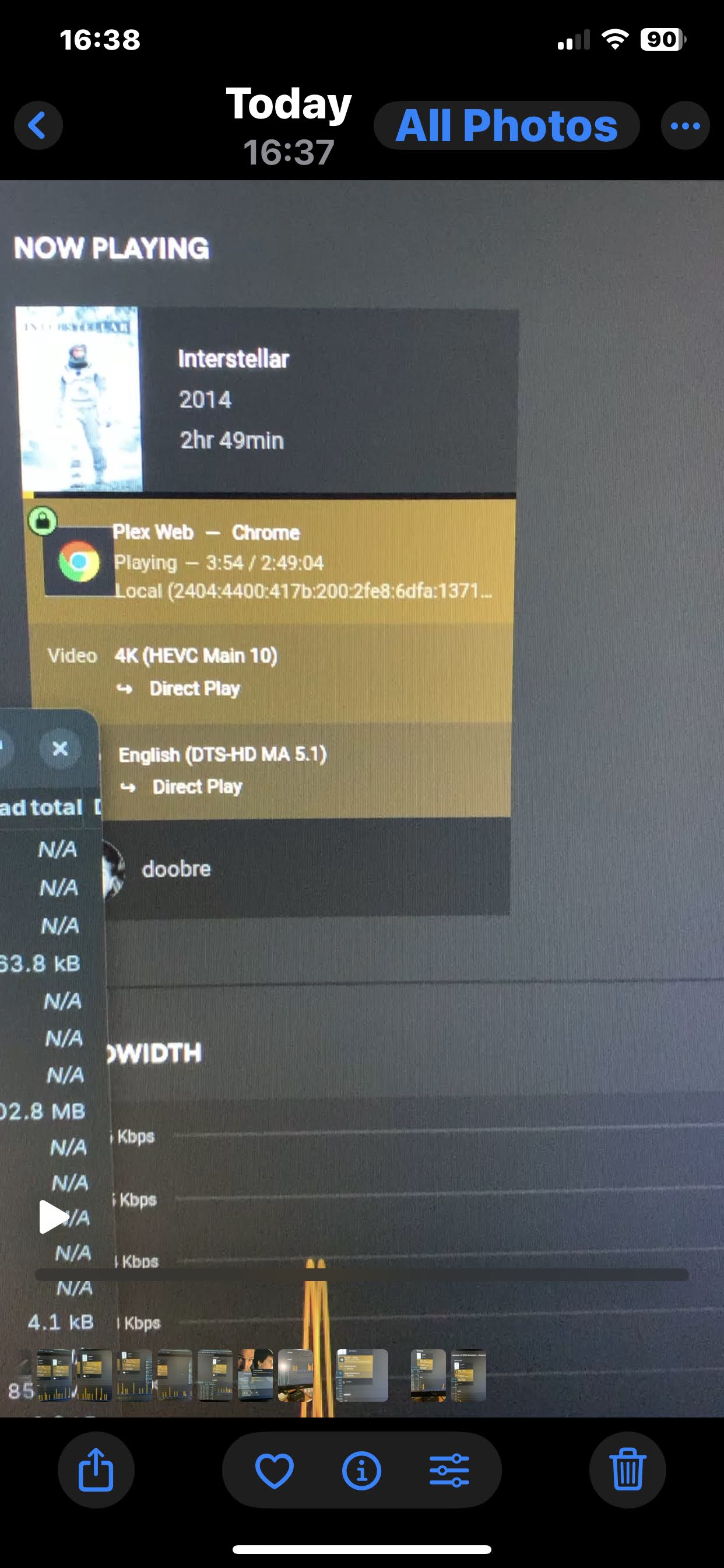

Same issue, Chrome on Zorin is installed via Snap which doesn’t have access to the hardware.
You don’t really have a 4k HDR monitor and DTS-HDMA sound system connected to that PC so the Plex Client needs to do some work that the browser on Linux can’t. You should be able to install Plex for Linux from the Snap store or hit the downloads.plex.tv for a link.
Do you mean I should install the .deb package for chrome/brave? cheers
UPDATED - I see what you are getting at. It is the local playback that is not going to a 4K monitor, and the browser cannot pretend it is. But in windows it can.
I checked the playback on the AppleTv which is connected to a 4K TV. That displays a 4K, and the dashboard on the Zorin plex shows it is “direct play”.
So I have been chasing my tail, sort of. Since I really only view the movies on the AppleTv in the lounge room, browser output is irrelevent.
cheers CD
Serving up the 4K to the AppleTv shows only 2.18% CPU on the Zorin dashboard.
