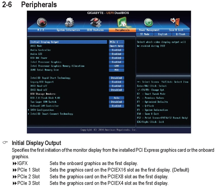

Below is a picture from my motherboard manual. I have a 750ti video card & a 4790K CPU.
If I set the Initial Display Output to PCIe 1, Plex uses the 750ti for transcoding. Starting with the third concurrent transcode, Plex uses the CPU, not the HD4600 iGPU, for transcoding.
If I set the Initial Display Output to IGFX, Plex uses the HD4600 in my 4790K for all transcodes, ignoring the 750ti.
