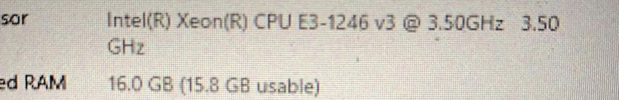

I forgot to say, my spec of the computer running the Plex media server is:
