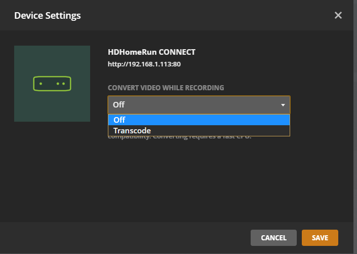

OK, just a few more questions… Can someone with the full Plex Pass version of the server share a screenshot of what the config looks like for post-airing compression of the DVR recordings? I’d like to see what the options are and whatnot.
Also going to try to narrow this down further. It sounds like the Extend is just not all that great of an advantage for my use case (letting the recordings happen, letting Plex do the compression at its own pace after the recording, watching recordings hours or days in the future), so let’s rule out the Extend. I can get either a new “Connect” for $60 (new), the “Connect Duo” for $100 (new) or the “Connect Duo” refurb for $70. I’m not really grasping what the difference is between the “Connect” and the “Connect Duo” when flipping between both products in two browser tabs… Leaning towards the refurb Duo with the assumption that it’s a replacement for the Connect and hopefully a bit better?

I haven’t tried live yet, but the DVR is working well. It transcodes on playback, and the i3 seems to just handle it with like 30% CPU left over, but it works. Still might add a post-processing script to save some space. Kind of weird that there isn’t just a built-in option to transcode after recording. Also wonder if I add a post-processing script if plex still goes in and makes the scrubbing previews after the file is processed?
