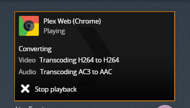

Next thing I tried was to simply play in a chrome brower using the Extend Hardware transcoding (set to Heavy). Chrome cannot play AC3 audio so this needs to be transcoded to AAC however Plex for whatever reason will re-transcode H.264 again instead of passthrough…!

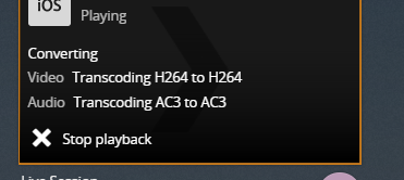

Same thing on all of the iOS & Apple TV’s which can play H.264 and AC3. Plex will still transcode. !
