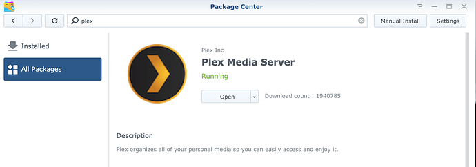

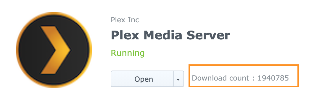

@DaveBinM Can you please provide steps to get this working on Synology NAS? Give PLEX application available DMS Manager, I can’t install the ocl-icd-libopencl1 beignet-opencl-icd packages manually.
I have attached a screenshot from DSM.

P.S: I can see 1940785 downloads of PLEX Synology APP and I think it’s not fair to abandon these PLEX users.
