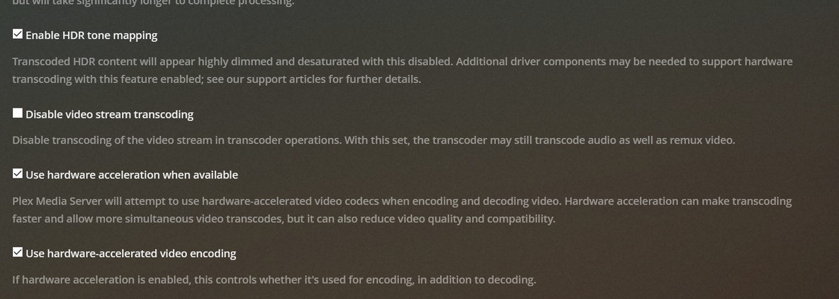

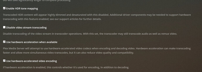

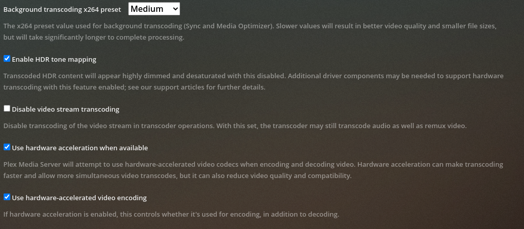

My problem is the new tone-mapping feature (which I’m super excited about) doesn’t seem use Intel HW encoding feature after installing the OpenCL driver directly to the host/master.
My setup is an Ubuntu 20.04 microkubernetes cluster on an Intel x86_64 Coffee Lake system, and I have exposed the Intel GPU resource to my cluster for HW transcoding - it works wonderfully for all content types, until now. When I try transcoding 4K HDR content now, it renders with the Software on the CPU instead. Looks great and is tone-mapped beautifully, but uses nearly 75% of the CPU! My guess is I need to expose the OpenCL driver resource to my cluster as well to get this feature working as intended on the support page for this (https://support.plex.tv/articles/hdr-to-sdr-tone-mapping/).
Is there anyone who would have any insight into what specific resource I would need to put in my manifest, or if this is the correct path to getting Plex to use my Intel GPU for tone-mapping 4k HDR content in k8s?

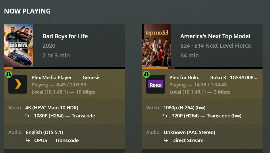

I’m experiencing this problem as well:
Ubuntu 20.04
Intel NUC10i7FNH w/ i7-10710U using Intel Quick Sync ver 6 (Comet Lake)
Transcoding 4k HDR to SDR only goes through CPU. If I disable HDR tone mapping, transcoding through hardware works fine for same file and all things being the same.
