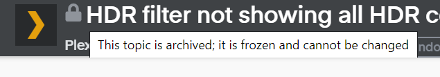

Both of those topics are locked though, so no-one can comment. I found the same issue today and ‘analysing’ the video fixed it.

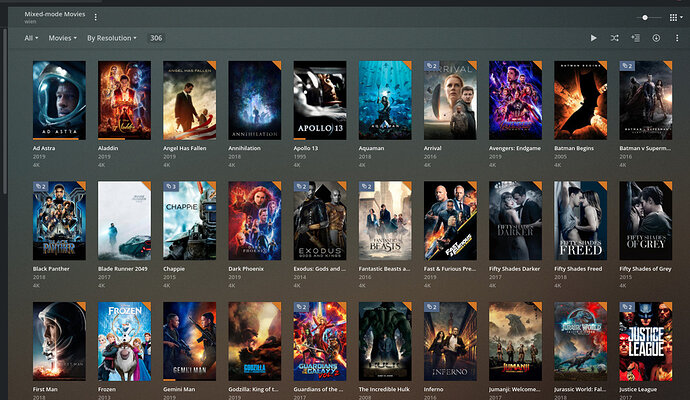

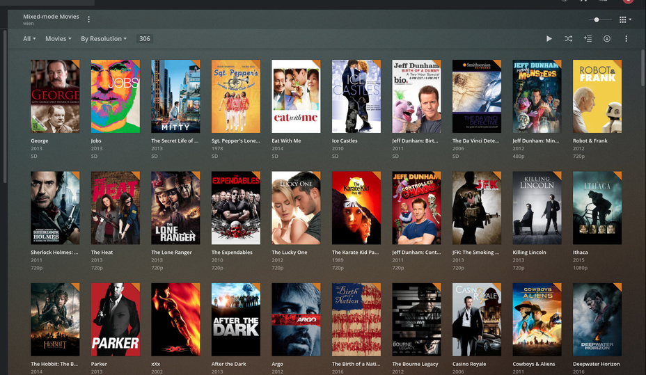

I have created a mixed-mode library. I cannot replicate the problem as I understand it. All movies are accounted for.
Shown below are the 2160p and 1080p movies, sorted ascending or descending by resolution.

Oh. Looks like I inadvertently did that. Sorry. Must of clicked the wrong button. I’ve restored it if you want to go back to that thread or I can merge this thread with that one.
