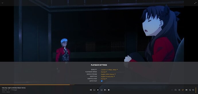

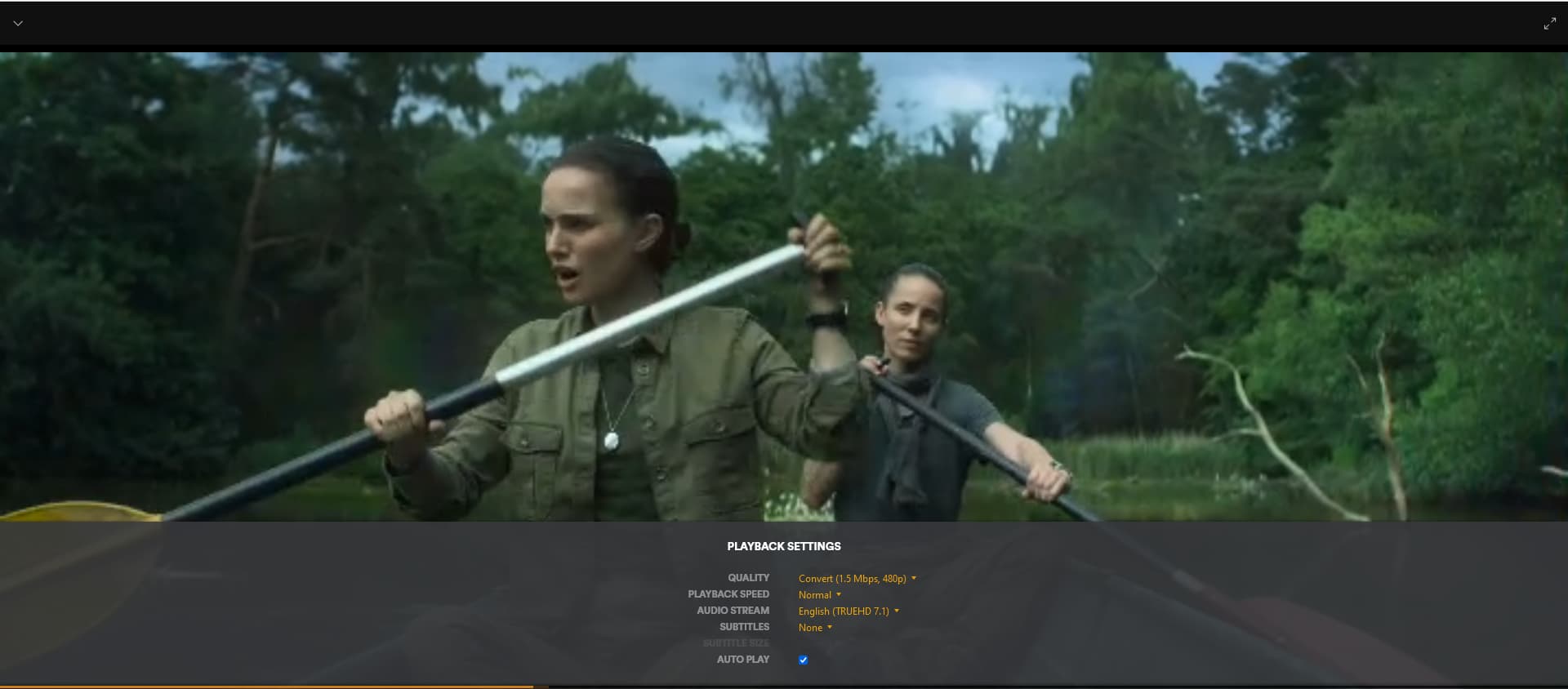

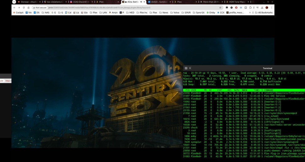

Seems to have mostly fixed browser based tone-mapping. Non browser connections (at least tested iOS) seem to still be broken.
(Image is from Firefox Browser)
Although this video still seems to have issues (Image is also from Firefox browser).

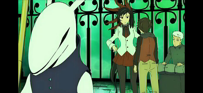

Image taken from iPhone iOS 17.5.1
I will need iOS app logs as I can’t replicate.
My mistake :man_facepalming: the above images are not from HDR video (or does not show as HDR in Plex Web).

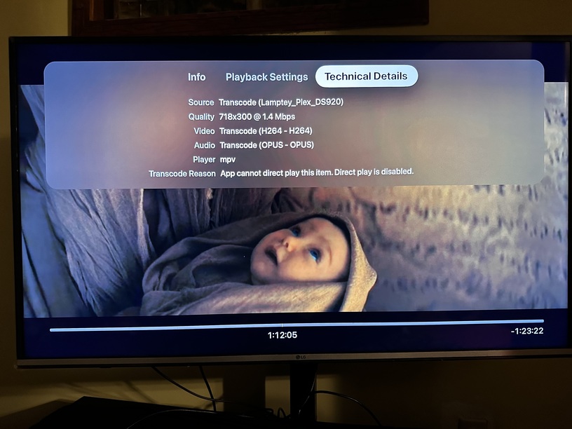

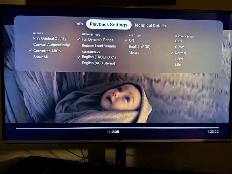

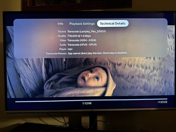

So the Codecs folder removal and restart looks to have fixed HDR content (I think), unless it was just has issues with non HDR content. I’m looking through some of the conent I tested previously to double-check.
I guess I was mistaken and its not the HDR content having the issues.

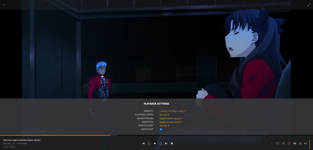

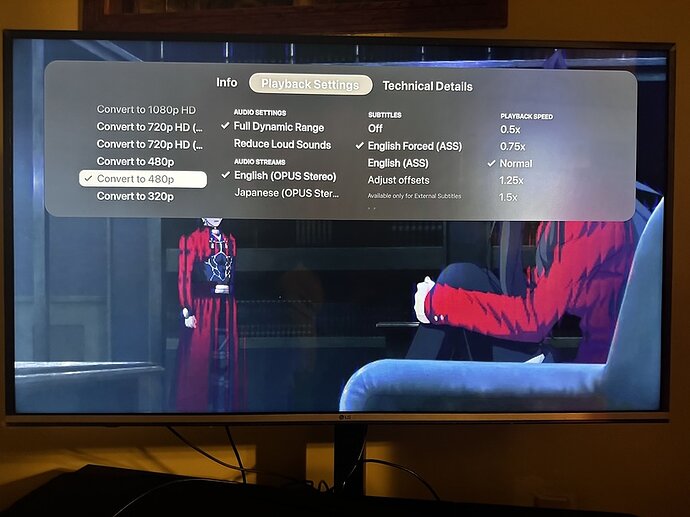

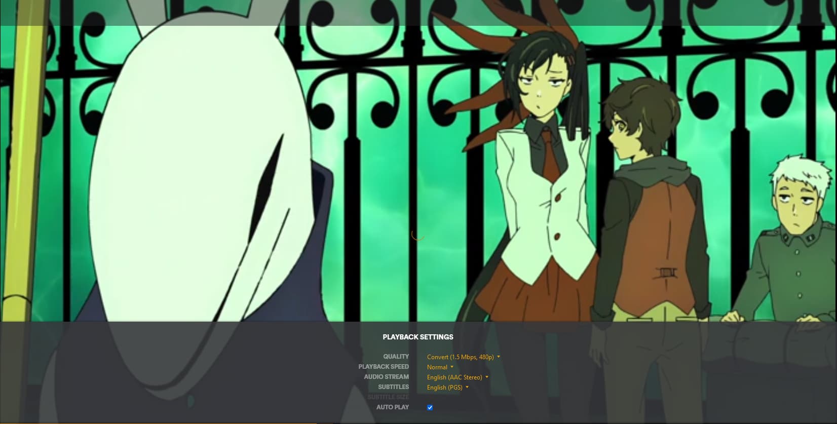

Video: 1080p (HEVC Main 10)
Audio: English (OPUS Stereo)
Subtitles: Englished Forced (ASS)
Firefox (no issues):
Apple TV 4K:

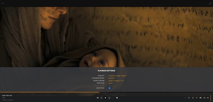

Video: 4K HDR10 (HEVC Main 10)
Audio: English (TRUEHD 7.1)
Subtitles: off
Apple TV 4K (no issues):

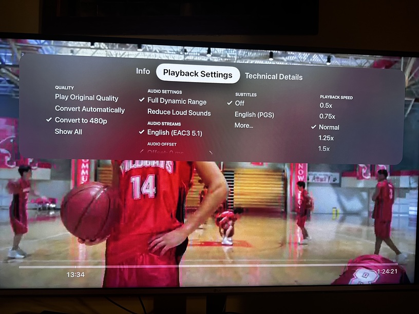

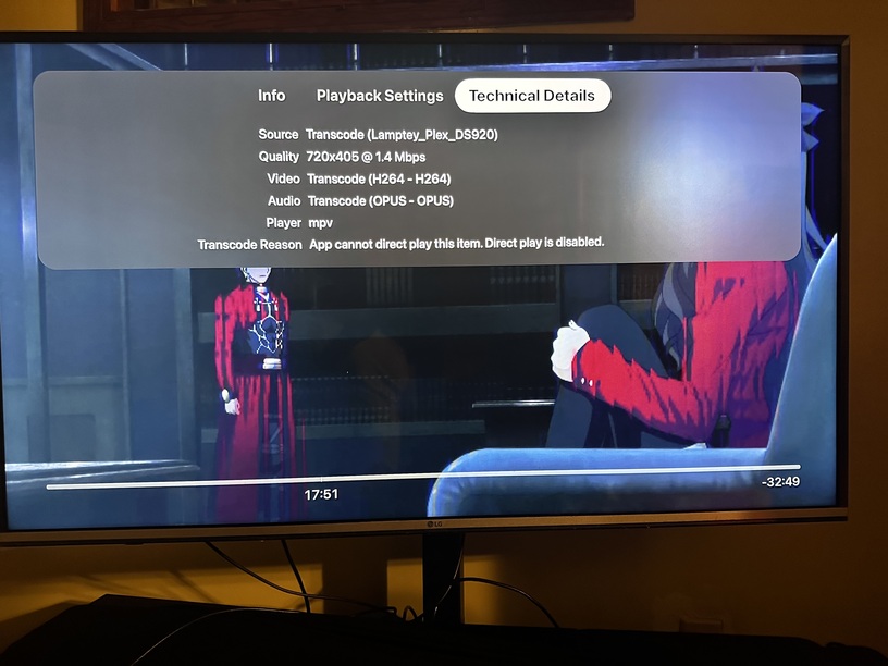

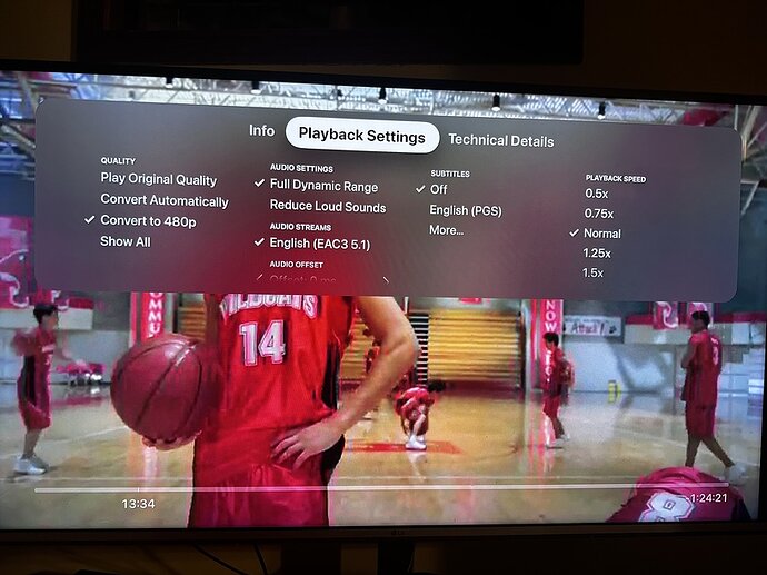

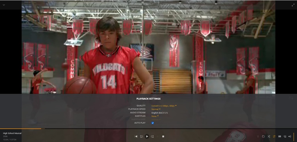

Audio: English (EAC3 5.1)
Subtitles: Off
Firefox:
Apple TV 4K:

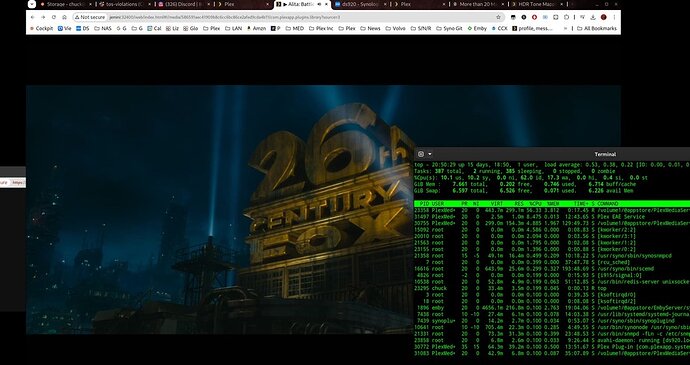

OK… results for you.
If you’re trying this way and not getting it, I WILL help you.
  1. Plex/web playback quality set for 20 Mbps (as a starting point)
  2. Movie is 50 Mbps HEVC HDR 10 movie
Duration 2:01:57
Bitrate 51150 kbps
Width 3840
Height 2160
Aspect Ratio 1.78
Video Resolution 4K
Container MKV
Video Frame Rate 24p
Video Profile main 10
  1. Playback perfect.
    – transcoding the audio
    – HW transcode video
    – HW tonemap
The issue with the DS920 is, as many forget, a “Basic/Entry level” GPU.
The UHD600 wasn’t designed to handle huge bitrates with multiple streams.
The UHD630 can handle up to about 130 Mbps output (i’ve tested this)
I can test for you but 1.40.5 (for right now) is
a. the best transcoding we have with GLK (FFMPEG 6.1 will change that)
b. is comfortable with 20-30-40 Mbps output streams.. Just remember it’s not a race car like the bigger GPUs. If you get 80 Mbps total of output, I would be very happy.
Please tell me how I can help make this work best for you and I’ll do it.
