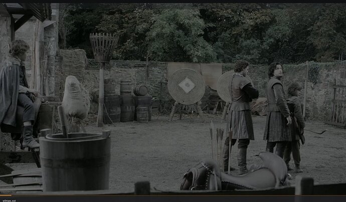

I just got it. Thank you.
Just had chance to test
Using the sample you provided
  1. With tonemapping enabled. (hable)
  2. With tonemapping disabled.
Correct?
First question.. Are you seeking into the playback or are you letting it play normally?
Hmm. That looks perfect. So I wonder if that is good news or bad news for me :sweat_smile:
I’m not seeking at all. I just start playback and while it is already running in direct stream mode, I change quality setting. Hable is a tone mapping algorithm right? I wonder where you are able to see that? I only know it from kodi but have never seen such a setting in plex?
I didn’t notice that either until now.
Yes, Hable is the tonemapping algorithm currently being used.
I don’t know why it doesn’t exist for the GeminiLake since it can tonemap.
I’ll ask the engineer and see what can be done for the next update.
As info, when we upgrade FFMPEG, we’ll probably go to BT.2390 which, on a computer monitor, is as good (IMHO) as watching it on the OLED TV.
I just gave it one more try without running tonemap disabled at first - to get a more clean log. The server just started up and I directly started playback. In the log I can already see

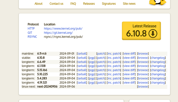

You stated 6.9 kernel?
You’re in docker ?
Why to each please ?
PMS in docker can be a ROYAL P.I.T.A
Kernels which I know work are 6.5 and 6.8
6.9 isn’t even on the kernels.org list
https://www.kernel.org/
Ah good catch. I was trying different ones and other stuff and was not aware it is still 6.6 enabled in this try. Perhaps was too tired already.
Debian stable is still 6.1, the general info here was to use at least 6.5. Current Debian bpo was 6.6 back then. Tried it. No luck. I assumed if it was a driver issue, updating Kernel may be worth a try. So when the latest PMS updates released, stating hw tonemap should work now on Gemini Lake too, I also switched to the latest bpo (6.9 back then). I was just trying to cover everything what could be the problem on my side. So I‘m giving 6.5 and 6.8 a try today.
What exactly do you mean by 6.9 isn’t even on the kernel.org list? It was in the stable field when 6.10 was mainline. The latest stable is listed there only I think.
Using docker is a no brainer for me. There is a ton of services running on my server. It is not Plex only.
This isn’t about running “mainline”… it’s about running “vetted” kernels.
That’s the key.
The main distros take a mainline kernel, tweak / fix things, and then vet it as the release kernel.
Those are what you want to run.
As for the 6.9 reference, look here:
I know 6.8 isn’t listed either but Ubuntu has taken custodianship of it for their distros. That’s what we have to go by.
In general, please stay with the distro releases and not kernel.org.
I’ve seen far too many problems by jumping off the beaten path.
