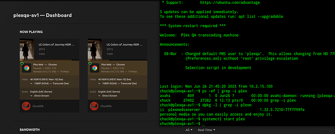

We have one AlderLake machine.
It runs as released Ubuntu 22.10.
root@plexqa-av1:/home/chuck# uname -a
Linux plexqa-av1 5.19.0-45-generic #46-Ubuntu SMP PREEMPT_DYNAMIC Wed Jun 7 09:08:58 UTC 2023 x86_64 x86_64 x86_64 GNU/Linux
While I would love to play with different kernel versions, I don’t have that luxury.
Ubuntu runs bare on the host. There is no hypervisor underneath it.
If there were, then I wouldn’t be able to run Unraid in a VM
(catch 22 situation)

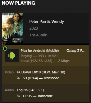

Debug logs attached. At 10:06 i started a direct play and then at 10:07 i started a Transcode. this is with Tone Mapping enabled.
Please let me know if you would like anymore logs or testing done :wink:
