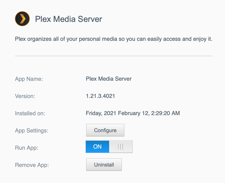

My AppleTv (local network) stopped being able to access my server this morning midway through playing an episode.
I took the opportunity to update the Plex Server version, and that happened successfully.
However, after updating the Plex Server, Plex is still unable to find the server, despite the server (MyCloudEX2Ultra) otherwise being accessible and displaying the Plex Server as being on.
I’ve tried rebooting the MyCloudEX2Ultra and also switching the Plex App on the MyCloudEX2Ultra from On to Off, and then back to On again as well.
I’ve not had this issue before after updating the server or not being able to access it in general. Any advice?
Screenshot 2021-02-12 at 10.38.16 Screenshot 2021-02-12 at 10.38.20

How did you update? I see your NAS is running firmware 5.x. You need to make sure you are running the OS5 version of PMS. From the downloads page, it’s this version.
It is cloud OS5 that the WD is running. And according to WD that is the latest firmware for that drive.
Reverting to an older version of Plex Server has resolved the issue.
