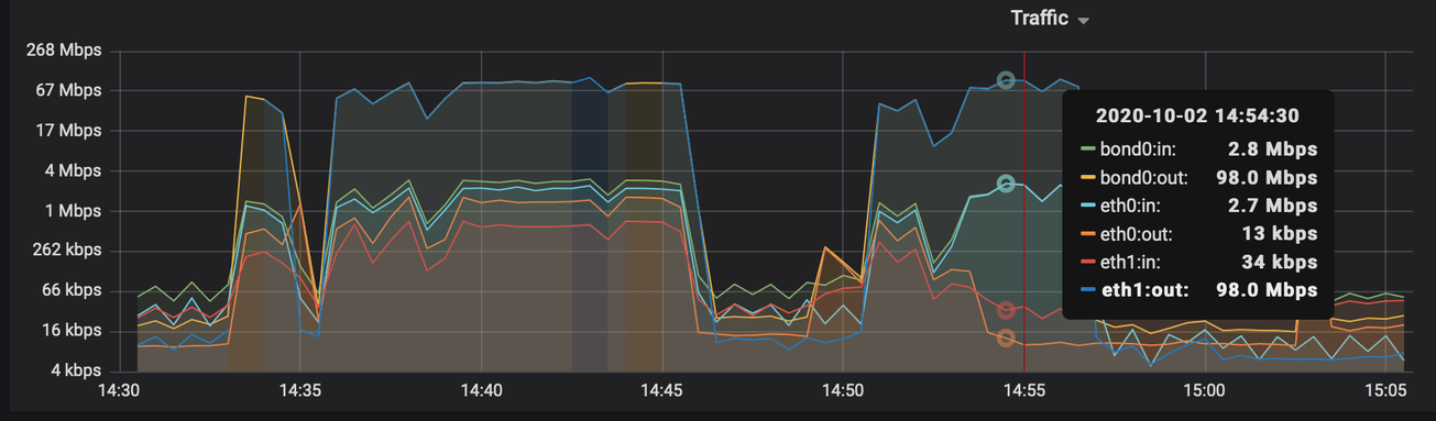

Im viewing the files from the Plex server (1.18.6 synology) via the “Media app” on the TV. Synology doesnt transcode or something and network is Gbit. Synology seems to be serving 100Mbit peak data transfer to the TV.

I think that its the network… probably the TV has 100Mbit as I can see a “hard limit” on the traffic to the TV and when the scenes go a bit crazy and the frame bit rate go crazy up the network hits the limit (my network is cool, pro/managed switch). Then its starts chopping the frames :S

thanks Ill test. This was the 30GB Matrix test via Eth.
Crazy but true!
Via wifi the file played with a steady 130-140mbit…
I cant believe even 2000gbp TVs have 100mbit Eths
