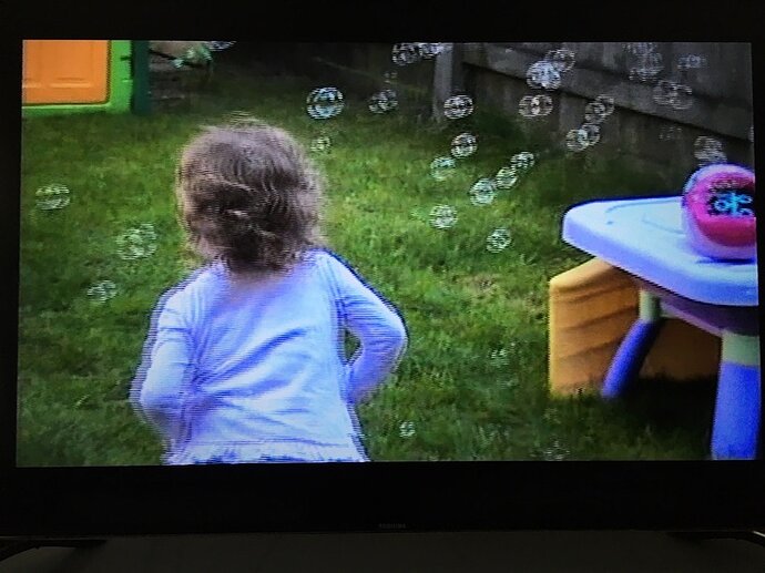

I want to put all my personal home DVDs on my server so that I can watch them using Plex.
I understand that Plex cannot playback VOB files so I used MakeMKV to make the VOB files into MKV files, which I believe is supposed to be lossless as there is no re-encoding.
However, when I play the MKV files on Plex the image is terrible becase there are lines on the video (like some kind of interlace). These lines become worse if the video footage is moving, the faster the footage moves the worse the lines become.
Below is a picture to show the issue.
If MakeMKV is lossless then why is the video playback so poor ?
What’s causing this and what’s the solution ?
Plex Media Server is running on my Dell PowerEdge T30 server which is running Ubuntu 16.04
Plex Media Client is running on Amazon Fire TV (2nd gen) on a Toshiba TV (55U6663DB)
Network connection is all wired (CAT5E)

That is interlaced video.
Not all Plex clients support de-interlacing video during playback.
Suggest you run the videos through Handbrake. Handbrake will transcode the videos from MPEG2 to H.264 or H.265 (your choice). When configuring the transcode, in Filters settings, choose Interlace Detection = Default; Deinterlace = Decomb, Preset = Default.
Start with those settings and see how it works, and adjust as necessary. It is not always possible to remove all interlacing artifacts. To save time, test with a short sample or chapter of a video until you get the best result, then process the entire move/show.

Not so much that you could notice - for DVDs it’s very likely, if you use the right magic tricks your encode will look better than the source - it sure won’t be interlaced and that would be a step in the right direction:
HD Above - 480p Below.
De-Interlace is in Filters/De-interlace/No Detection/Yadif - Default/Lapsharp/Light/Film (probably, but pick Animation if necessary - like if you’re encoding animations).
More than about 2500Kbps is a waste of time (for DVDs/Standard Rez), but do a 2 pass at whatever you decide on.
BTW - there should be a setting in that recording device (are these from a camera recorder?) to disable interlacing. There is no earthly reason to have it on - if you have a choice.

I used Mediainfo to get details of the VOB file on the DVD and the results are shown below:

Right - interlaced.
I’m hoping - 'cause I don’t know - Handbrake is smart enough to know the dimensions for you - PAL are going to be 720x576. If that actually happens, remains to be seen. By you.

With ā€˜None’ Selected for Anamorphic - Drag and Drop that thing on Handbrake and it should just use 704x576 - like it is.
Use the same settings elsewhere - Same as Source/Variable Bit Rate, but change my Average Bit Rate to 9000Kbps (to maintain as much quality as you can, but I can tell ya anything more than about 2500Kbps is a complete waste of time for DVD material). Use 2 Pass (with a lower bit rate - this is precious cargo - but you can’t turn a sow’s ear into a silk purse with bit rate).
Under Filters do as I suggest - create some 240second previews, put them in an Other Videos Library and watch 'em on some things.

It’s worth noting there is a big difference between different deinterlacing methods. Some clients have deinterlacing but the options can vary widely.
  • For streaming boxes it’s typically what’s available in the device’s hardware and usually this is one of the worst deinterlace methods.
  • PMP and Plex For Windows/MacOS use MPV as it’s playback engine which will use a method that depends on which hardware decoding is in use. For software decoding it uses yadif which is typically a decent deinterlacing method. You can examine the source for more details
  • Handbrake has yadif and also has a method called decomb
For deinterlacing to work properly, you often need the frames to be properly marked in the source media. This isn’t always the case. Recently I looked at the DVDs for Stargate SG-1 and noticed:
  • The DVDs for several seasons were marked as progressive even though the content was clearly interlaced
  • Some seasons had random episodes within a season marked as progressive but again were clearly interlaced.
  • Even when the media was marked correctly as interlaced, the field dominance was sometimes wrong causing the deinterlace to perform the wrong operation (on a scene change from scene A → B, the deinterlace would show frames like the following: AAAAABABBBBBB)
I fought these files using every single deinterlacing method in FFmpeg but the incorrect field dominance defeated most of them. With the first 7 seasons of this show, I had to run them through handbrake using the decomb deinterlace method to yield the correct results. Also important is I had to set handbrake to use a constant framerate that was the same as the source which for these yielded 23.976fps so the client would output to the TV at correct refresh rate (for this content)
The best method is going to depend on the content. Usually yadif is quite good but there are exceptions (see my field dominance example) where it falls flat. I ran across some posts where people couldn’t find an acceptable method for some content between Avidemux and Handbrake and ended up having to use the AI-based method available in FFmpeg which runs at single digit fps on modern hardware. So expect to be surprised on occasion with some of the more ā€œcreativeā€ interlacing that people do.
