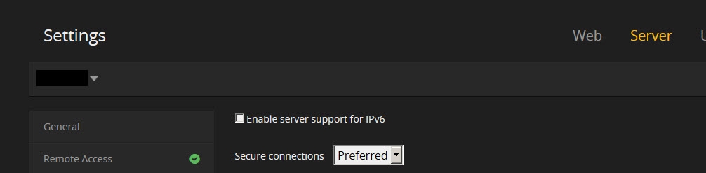

The only mention of IPv6 that I can find in Plex is the setting on the Server/Network page. You’ve probably already found this, but just in case:

Some friends can access my plexserver, but there are very few, only a few, My settings look like this:
