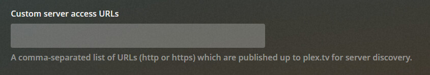

Did you configure your custom domain (and probably a certificate) in the plex network settings? It sounds like plex is not aware of the custom domain so it is relaying it through the ip that is registered instead.
“Custom server access URL”
I have all my services running behind a reverse proxy with a wildcard TLS certificate. Everything is working fine accessing via web browser.
Plex is aware of my domain, as I can see it in the sidebar of settings in the web. But I haven’t configured the certificate paths or domain name in the network settings. Are these settings mandatory for accessing my PMS with the Android client?

Can you verify that this is populated.
Also, can you verify that the android app is using the same account to log into your server? It sort of looks like the app is working and you are using a different user with the sharing setup incorrectly.
Hi, I have filled the PMS URL there: https://cine.mydomain.com.
