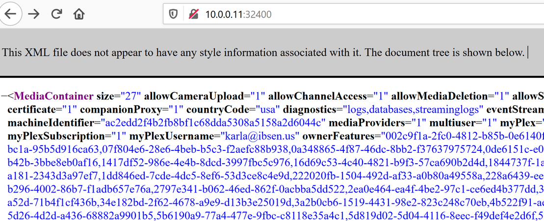

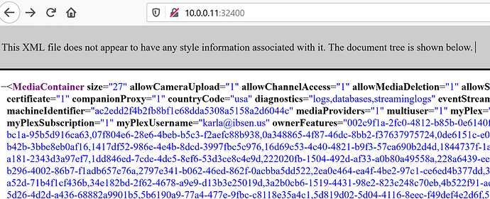

No, the issue is that the URL above is missing the folder.
try http://10.0.0.11:32400/web
Thanks again. It’s always something, isn’t it?
