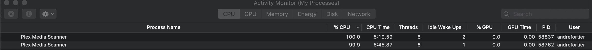

What is your CPU doing while scanning? Is it sitting there ticking over or is it hitting a high percentage of utilisation?
CPU utilization is super high - Plex Media Server - 99.8% - 100%. I have lots of memory on this computer - 128GB, so memory is not an issue. Nothing else is running other than the basic OS items.

Most of the scanning/matching is single threaded, so it will generally max out one core, and generally that will be the bottleneck, how fast a single core cpu is on your computer.

CPU busy is 100% on the Plex process. Nothing else running other than basic MacOS running latest Catalina 10 15.6.
