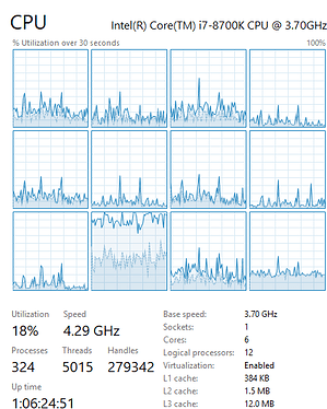

Hey @chrisallen. It seems to me like it’s a Quadro driver issue. I have done a ton of testing before but I just redid my testing.
My server is windows 10 pro with a P2000. I tested emby and Plex both on my server and then on my gaming pc(they performed similarly). My gaming pc is windows 10 pro and a 1080ti. All testing was 4K h265 10 bit hdr remux transcoding to 8mbs 1080p. Both are running the newest version of Plex beta.
On the server, it doesn’t “engage” correctly. It transcodes at like .2-.8x so way too slow to watch even 1 stream. But it’s not utilizing the gpu correctly because encoding and decoding usage is way too low. Like 7%. I’ve tried countless things to fix this.
On my gaming pc. It works correctly, easily got two streams on it smoothly. My driver is locked and I don’t have Tautulli on that setup so I can’t give more details than that. But when I check task manager, it’s using like 40% of the decoding chip. 20% of the encoding chip. Along with 4.8gb of vram.
That’s strange as I too have tested on my gaming PC (6 core xeon e5 1650 v3, gtx 1080 ti, windows 10) and it behaved exactly as my windows vm with p2000 passed through.
its 16gb 4k file
