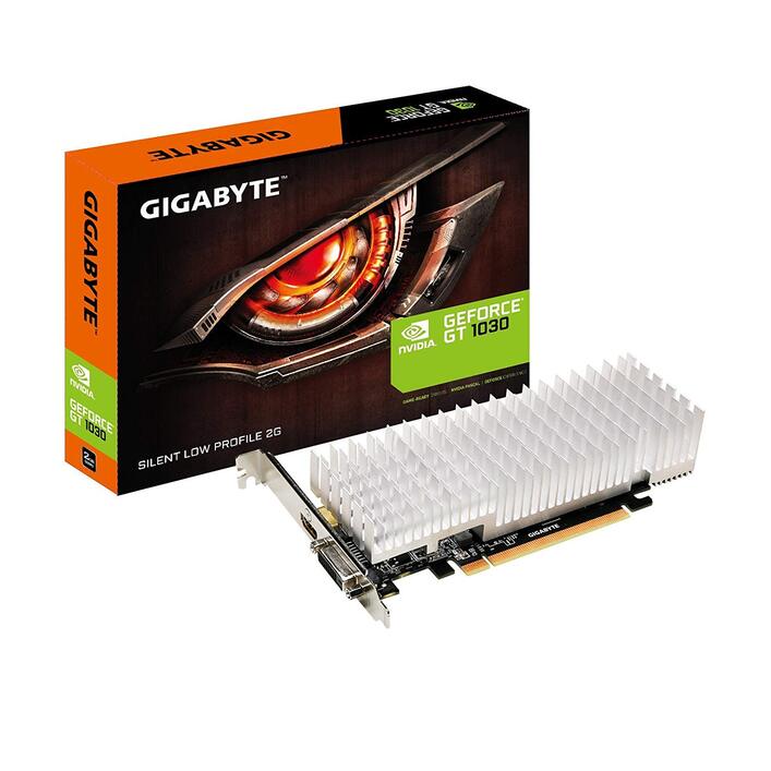

Ok lets step back and think about this for a moment…
Transcoding was explained to me many years ago as a 2 step process
First Step: Decode the video - I picked up a GT 1030 specifically for this plex server, its a 30w card that can decode Hevc - on sale 70 bucks
Second Step Encode the decoded video to a different container - The CPU gets to handle that.
I was still having a problem, just like what you describe, it would send to the TV and fall flat on its face. Buffering, Buffering, Your connection is to slow etc. etc. etc.
my fix for that was a archer C7 router - on sale 60 bucks
The gigabit connection to the router and the dual band made all the difference for me.
The system is a 1700x with win10 pro running off a ssd , I’m not using a ram drive, just plain old enterprise 3tb hard drives 2 for movies, 1 for Tv Shows and 1 for Music.
Take a close look at the picture I posted I was serving up the same 4k HEVC move to 2 different TV’s at the same time, and never missed a beat.
I couldn’t be happier with this system as far as its low power use and its ability to serve up media, my only complaint is the TV Guide, but I’ve managed to install a different one and have it working now
My recommendation to you is, get on the server, fire up a player and run a 4k movie and see what it does, if it falls flat I would think its a decode issue, it it plays fine look at your router setup
Good luck I hope this helps
