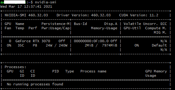

I’m running PMS on an Ubuntu 20.04 server with AMD 5950x CPU and Nvidia RTX 3070 GPU. I have the nvidia drivers installed and nvidia-smi works correctly.
The Plex installation shows that it finds the GPU:

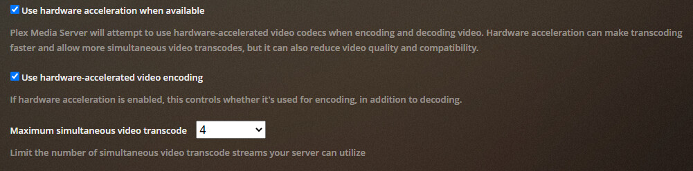

I have the options enabled:
But it still doesn’t use hardware encoding:
What am I missing?

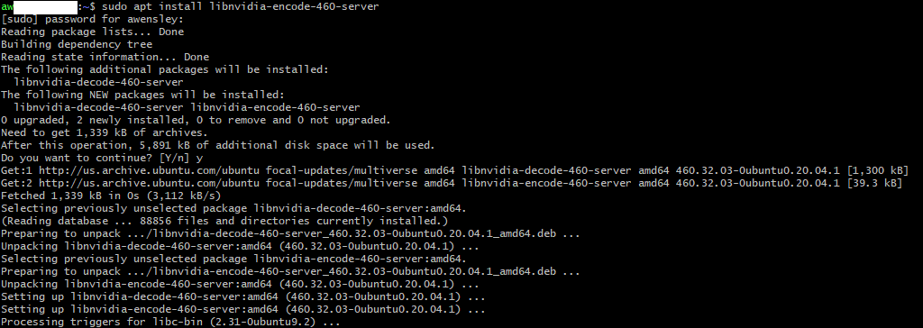

Looks like this is the relevant section:
Mar 17, 2021 11:57:10.476 [0x7f888dffb700] ERROR - [Transcode] [FFMPEG] - libva: vaGetDriverNameByIndex() failed with unknown libva error, driver_name = (null)
Mar 17, 2021 11:57:10.476 [0x7f888dffb700] ERROR - [Transcode] [FFMPEG] - Failed to initialise VAAPI connection: -1 (unknown libva error).
Mar 17, 2021 11:57:11.362 [0x7f888dffb700] ERROR - [Transcode] [FFMPEG] - Cannot load libnvidia-encode.so.1
Mar 17, 2021 11:57:11.362 [0x7f888dffb700] ERROR - [Transcode] [FFMPEG] - The minimum required Nvidia driver for nvenc is 418.30 or newer
Mar 17, 2021 11:57:11.382 [0x7f888dffb700] WARN - [Transcode] Codecs: avcodec_open2 returned -1 for encoder 'h264_nvenc'
Yup. That was it.
I had to install libnvidia-encode-460-server
Now it works:
