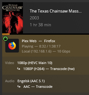

Doing some tests I can see in the Dashboard “Transcoding (hw)”
Screenshot 2022-10-23 115810
but according to the logs, there is no hw transcoding happening
Oct 23, 2022 07:57:54.776 [5984] DEBUG - [Req#25e/Transcode] TPU: hardware transcoding: enabled, but no hardware decode accelerator found
Oct 23, 2022 07:57:54.787 [5984] DEBUG - [Req#25e/Transcode] TPU: hardware transcoding: final decoder: , final encoder: mf

I’ve done a new test.
  • Rebooted
  • Logged in locally - not with RDP. Monitor active.
  • Started a movie in Firefox in my own PC. This requires transcoding (HEVC Main 10)
Oct 25, 2022 14:45:45.239 [10944] DEBUG - [Req#ca/Transcode] TPU: hardware transcoding: enabled, but no hardware decode accelerator found
Oct 25, 2022 14:45:45.260 [10944] DEBUG - [Req#ca/Transcode] TPU: hardware transcoding: final decoder: , final encoder: mf
It looks like when PMS is starting as a scheduled task before I log in, HW transcoding is not available.
