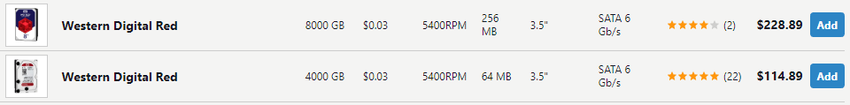

From pcpartpicker.com:
From my Synology DS414 with 4x4TB:
